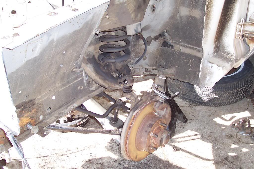

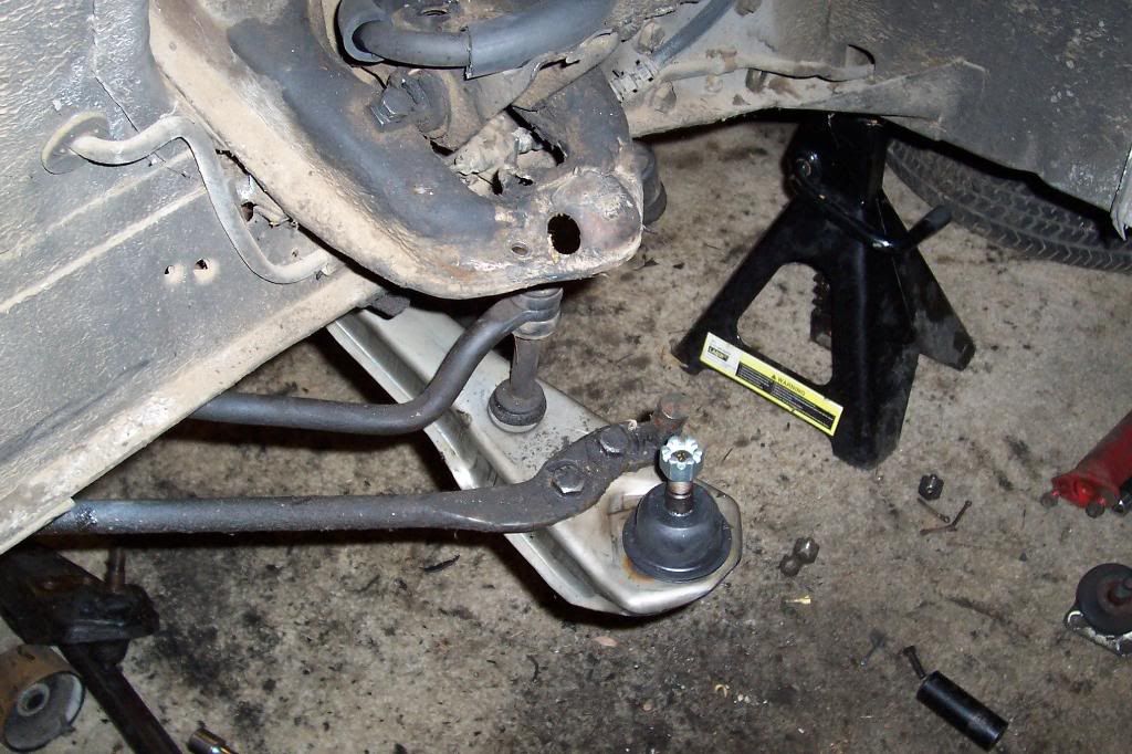

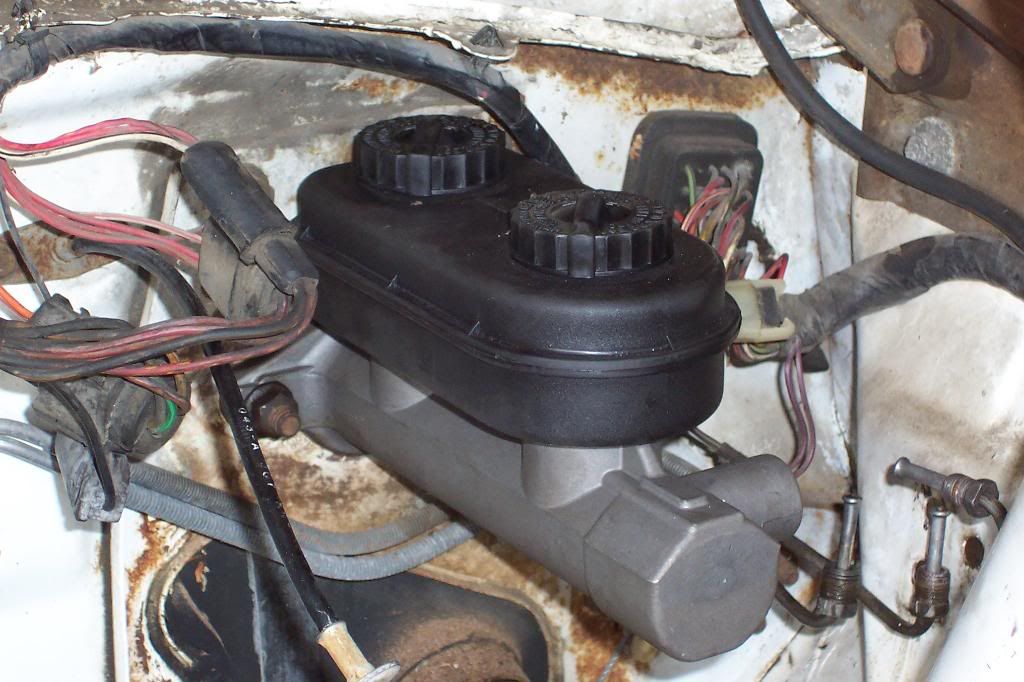

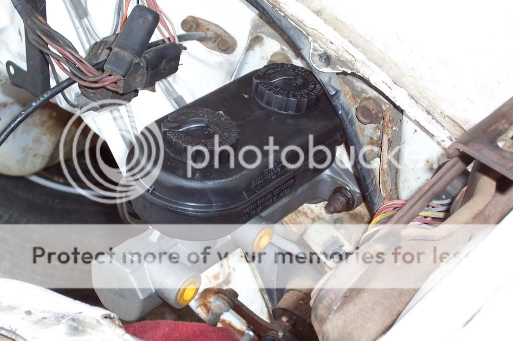

    Got the front done last night, and spend most of today cleaning it up some. I still have to run new brake hoses in the front, and get the MC and proportioning valve connected to the hard lines. I cut 1 1/4 coil out of the front coils, and I'll get a 2" lowering block for the rear. I got the MC bolted up and it looks good in there. I screwed up and cut too much off the old pedal rod, so I have to buy a new one to modify, or hit the JY. All in all it went pretty easy. I also changed out the upper and lower ball joints. I'll get everything all greased up when I finish the rears, I'll probably start on that Thursday night.

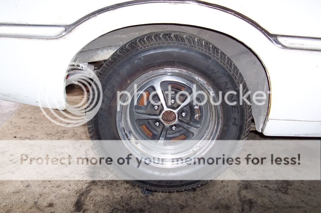

    Yep rear Disc brakes!!!! (y):D:clap::bowdown::yahoo:
    Now I have disc all the way round, I'm pretty stoked about this, as you can tell. I'm still yet to order cross drilled and slotted rotors for the setup, but for now these will do, as I don't even have a engine in the car yet.:rofl2:
    I also got all new shocks, and managed to get the rears installed this weekend since I was under there anyway.:oops:
    I'm trying to get all this stuff out the way first, then move to the engine, then move to interior and paint.
    I honestly wanted to keep the parking brake off the rear setup, but it was a no go. So I'll have to figure something else out for that when the time comes. I live in a really flat area anyway, and honestly can't remember the last time I've had to even use a parking brake so maybe I won't even deal with it.:huh:

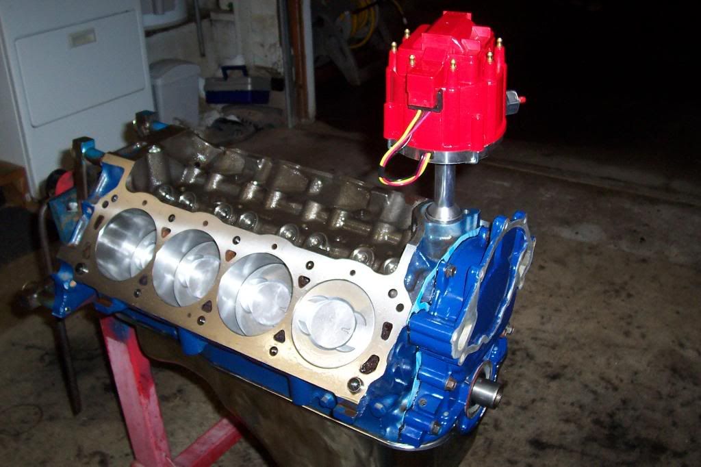

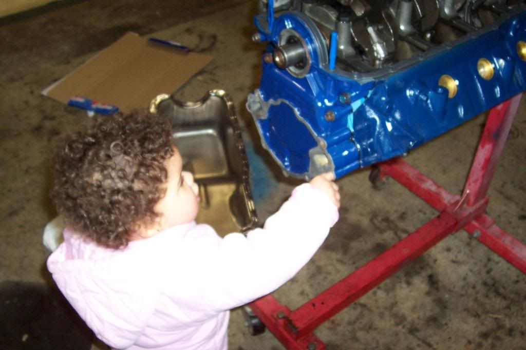

    A little more progress
    Got the oil pan, timing cover, and HEI distributor installed tonite.

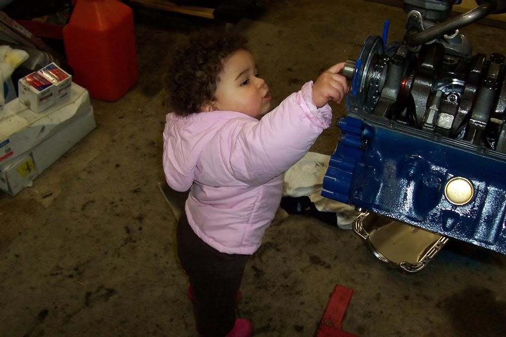

    My daughter even decided to come out and help a little
    It was a good nite!

    great!!! i see your beautiful daughter doing the quality control part, inspecting and demanding more efforts:rofl:
