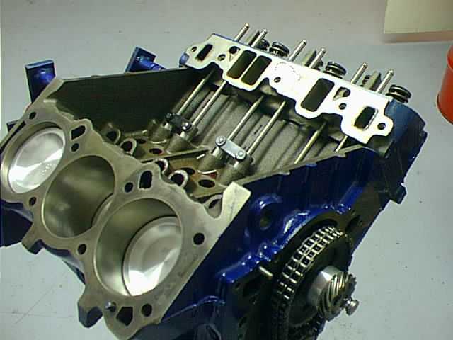

    For starters it’s not a v6

    it's not? i did the Vin check and it showed 6? but enlighten me, i know nothing about it

    A V6 has the cylinders in a V shape.
    An inline 6 has the cylinders in a row.
