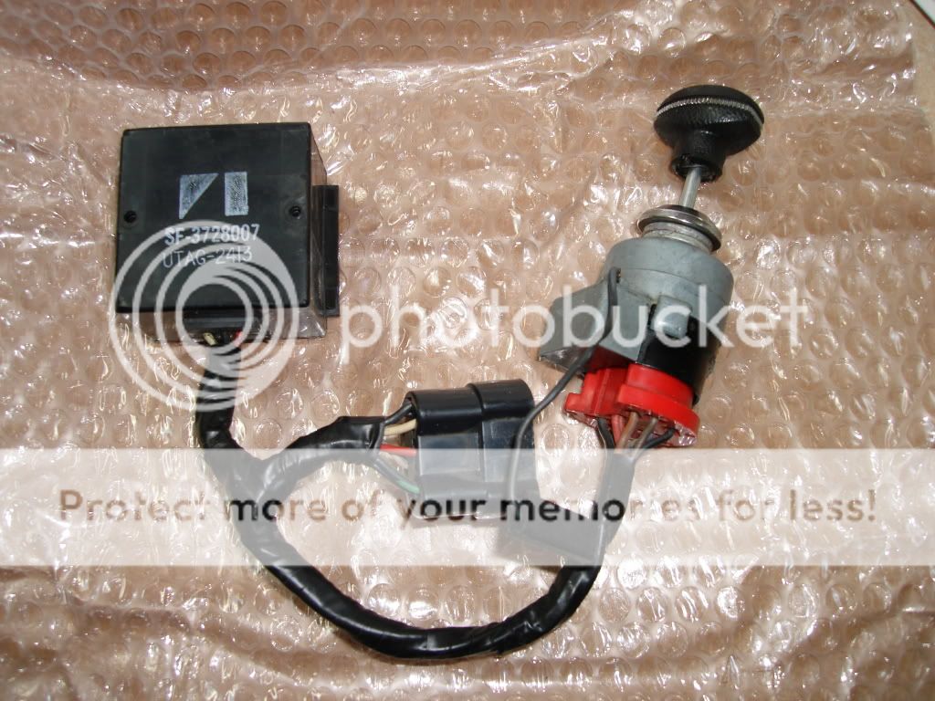

    Nice job! I'm at the finishing stage of my wiring mods ao I know how damn time consuming it is. Where did you get the nifty tools for removing the pins from the plugs? And I first apolagize for sidetrackin but I also have one of those wiper delay setups but when I try to install it the shaft is too short and the knob won't stay on. Anybody know what the problem could be?

    So you had the same problem with the intermittent switch Jeff? There is nothin wrong with my knob, it works fine with the original switch which has a longer shaft.

    the "self help" knob comes on a longer shaft...:yup: then you have 2 different knobs. I went to a big truck assy. shop and got me a pair of knobs that matched...(y)

    The knob from the HELP section uses a set screw instead of the internal clip. You just need the knob and not the shaft that comes in the repair kit.

    It's just so odd. I put a delay setup on my 75 maverick back in the day and I didn't have this problem. That one may have actually come out of a maverick though. Does the knob from the help rack match the original knob?

    The knob is all chrome. You can buy 2 kits and have a match

    I think the 73 and up have the bezel behind the switch knob. I don't know if its thicker than just the retainer and spacer (70-72) but my stock Maverick knob attached directly to the switch shaft, no problem. I use an 89 Bronco switch, if it makes any difference.

    Yup the switch is the same.
    Now just so you are aware, the old jeeps had these too. Actually the wagoneers and the cherokees from the late 70's always had these and I have had an easier time finding them in those then the ford trucks, because they always get scavanged from the trucks.
    The were made by Ford for AMC and they are plug and play with the ford setup too.
    They look like this..see the difference,(this happens to be for a CJ) it has a different knob, shorter thread area and an AMC stamp on the govener box.
