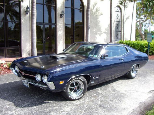

  15. ratio411
    ratio411 Member
    Apr 22, 2002
    6,060
    138
    Pensacola
    1972 Sprint and 1975 Maverick
    :wow: :bowdown: All hail Torino Cobra!
