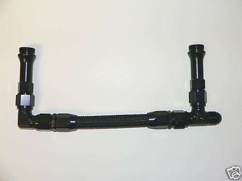

    is there a difference in distances between the fuel inlets from a 4150 and 4150hp?

    I wouldn't think there would be a difference in the distance between the inlets...BUT, the inlets could be different sizes...not sure. I know I had to buy two different sets of stand-offs for my fuel line, which is similar to the one shown. One set for the BG Demon, and one set for the Quick Fuel E85 carb...

    For $50 its a great deal, no shipping. Hope its a good piece. I got a femal AN to hose barb. We'll see how it goes, the AF gauge is hooked up so i should be able to tune it well.
