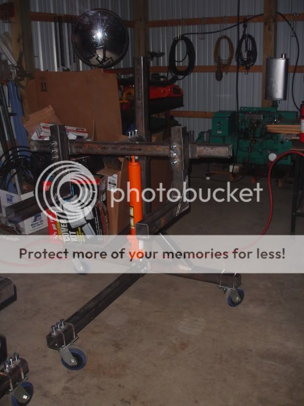

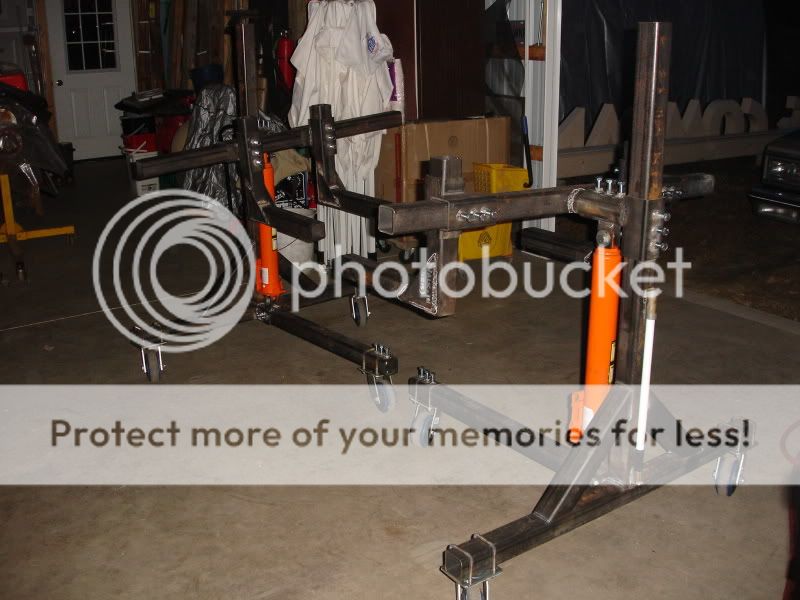

    We made these... about $400 total, including the rams.

  11. mercgt73
    haha, I guess they DO look like shopping cart wheels! That is actually the one thing that needed upgraded. Those wheels did not last, the rubber keeps popping off of the rim.

  15. mercgt73
    Nice! A word of advice, wherever you get your steel from, have THEM cut it. The place we go to charges a little bit more, but it is VERY worth it.
