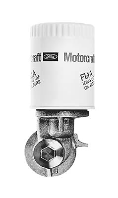

    Quick update on my project:
    Deciding which front deep sump pan to order. Canton is probably
    the bestest. But my budget says look elsewhere (used?).
    I also am going to get the oil filter adapter
    (Summit P/N FMS-M6880A50 @ $51.95) to allow the use of the
    FL-1A filter. The 6208's interfere with the filter in it's current
    location. Trying not to lose all this text here, so without looking I
    believe you guys who are running the 6208's are using a smaller
    filter (P/N?), this adapter, or a remote oil filtering device?
    Found HERE.

    Small fram oil filter #3682:)

    I saw the Motorsport filter adapter mentioned. I also have to use one. I use a FL-300A filter rather than a FL-1A. I also cut off the little ear so I could turn it about 270 degrees. The "ear" limits how far you can pivot it. Also, some late 70's 3/4 ton vans (460's) had filter adapters on them, but are a different design and you need the block fitting in order to make it all work. The Van adapters do have threaded plugs in them, so I think you could use an oil cooler with it....or screw in a temp sender or pressure sensor. Good thing about the van adapters...you can pretty much turn them any which way you want the filter to point, and with the filter pointed downward, it is STRAIGHT down..not slightly angled as the Motorsport one does. Also, they can be had for about $10 at the junkyards.
