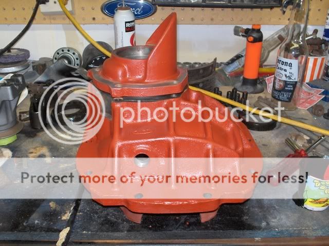

    Heres a pic of the rearend carrier, the filler hole plug has been removed, might help ??

    Wow thanks. I am changing the oil as the car is 35 years old and it's probably never been changed, Thought it might be good for it
