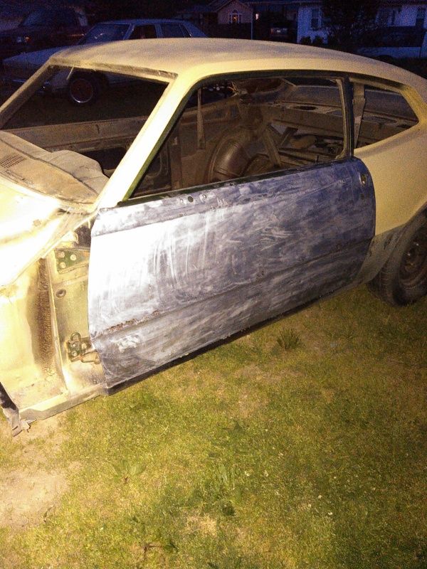

    Spent a little time on this car last week...been trying to get a new job going since I lost mine. The waiting period gives me time to work on the Maverick, though!
    Pulled it out of the shed, started sanding the body down.
    Got it about half sanded back, etched and ready to prime what I've sanded:
    I replaced that driver's door, BTW, picked up one from Craig Selvey while I was visiting my sister at school.
    That's about it for the day...Need to pull the other (not so good) fender off and finish sanding and priming that cowl panel, and start sanding down the door jambs and around the glass channels. From there, I'll finish pulling the rocker panels and get them half straight, do the quarters from the bodyline down, and across the back of the car. That'll have it in a position to not rust while I work on the driveline for a while.
    Got the door etched and prepped, but it was dark so primer will wait a bit.
