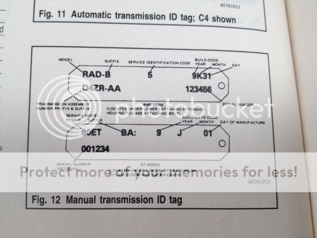

    Here is the info from the shop manual I have. It may or may not be of any help.
    This is the manual:
    Racer_X likes this.
  6. Racer_X
    Racer_X Maverick Hugger
    Nov 8, 2007
    1,191
    North Carolina
    1974 Maverick (1970 clone)
    more helpful than the internet has been lol
