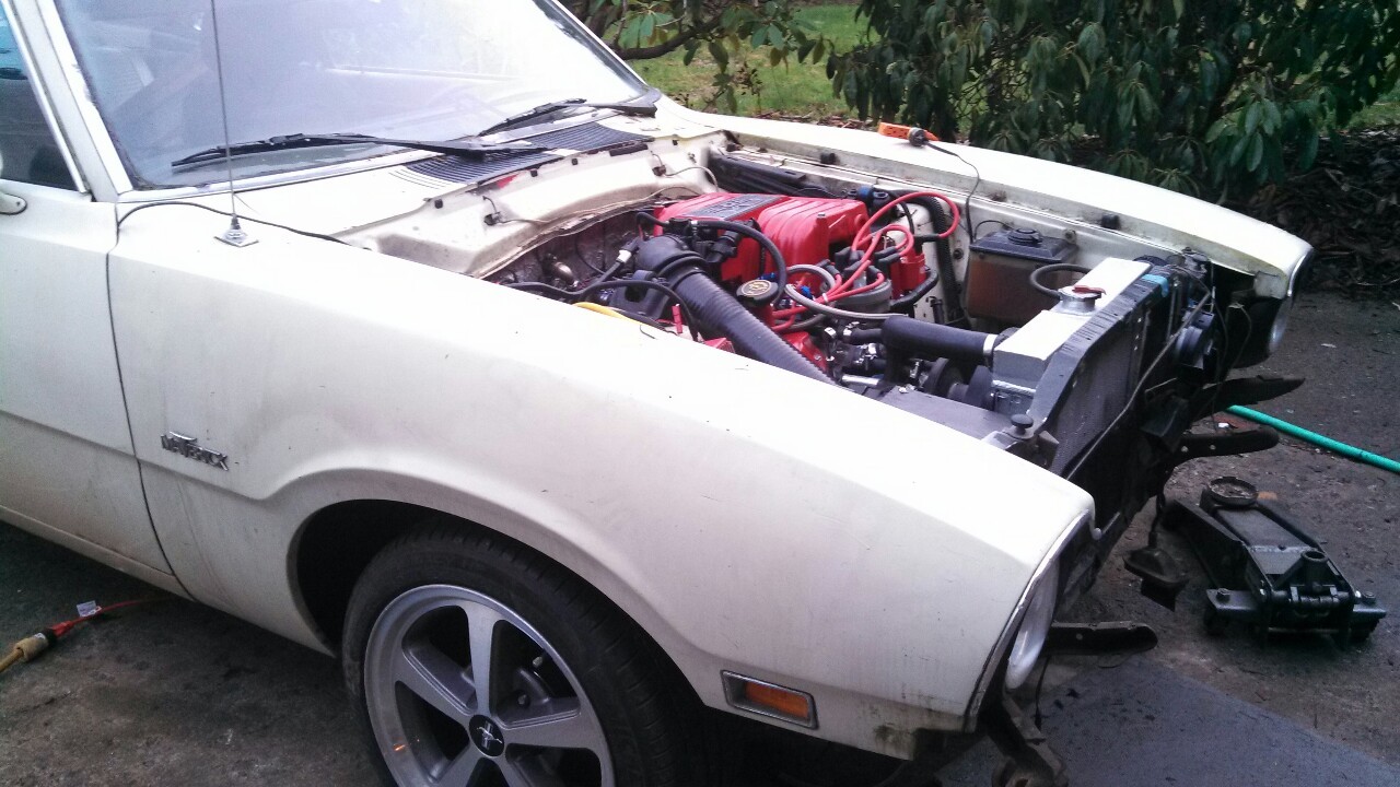

    [​IMG] [​IMG] Got it all back together now! I got it fired up and even drove it a bit, and I'm starting to work out the kinks in the tune. I need to get the fast idle worked out because for now I have it wired to a switch on the dash lol.
    Without the bumper it reminds me of Facelessnumber's car-- I think I will black out the bumper in the future.
    zeidrach, the MegaSquirt uses a speed density system so no need for a MAF, but good to know.
    Thanks for the kind words all!
    For some reason I can't get the turn signals to work right now. They worked last year when they were all LED so I don't think it's because of the LEDs. I cleaned the fuse block and I replaced the flashers and still the turn signals only work when the headlights and parking lights are off. The hazards don't work any of the time pretty much. The turn signal indicator lights in the instrument cluster don't work, but all the other cluster lights work. I cleaned all the contacts on the instrument cluster connector. I'm stumped. I'm thinking it's got to be the turn signal switch but I don't know. I will clean the grounds on the front marker lights and see if that does it first.
