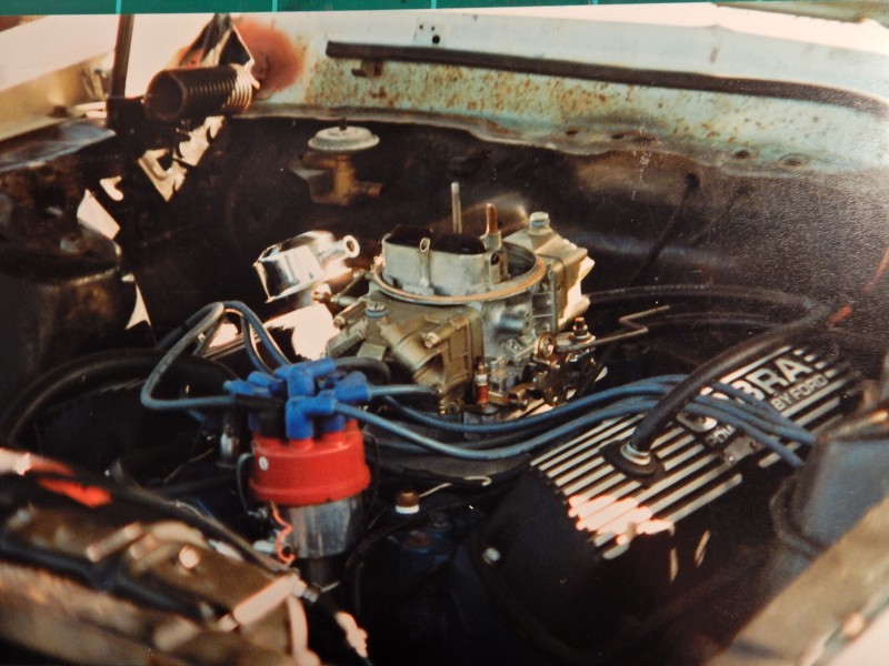

    This is the only picture I can find of the engine as of right now and this is in car #2. A 351W from a '69 Mach 1 with 4 barrel heads, Comp Cams 280H cam, MSD Unilite Ignition and a Holley 650 Double Pumper. It also had 11:1 compression. Note to everybody out there that knows anything about cars. NEVER do that on the street. You're guaranteed to be plagued with detonation problems unless you run HIGH octane fuel all the time. (98 or better). This engine did make this car haul like a scaled assed ape though.

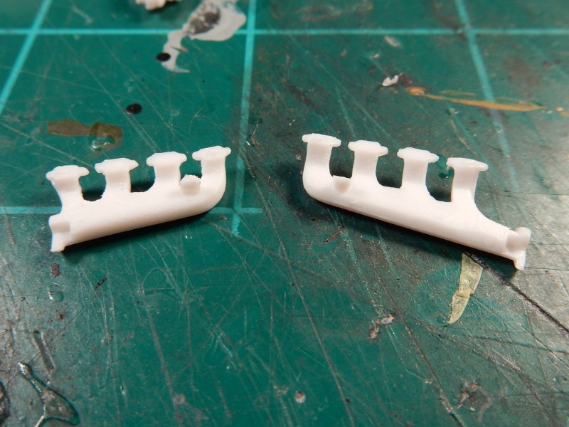

    All of the engine parts needed cleaning up but the exhaust manifolds were the areas that needed the most. When cleaning these up with the X-acto blade you've gotta be careful because this plastic is REALLY soft. You can take off more than you want quicker than you're ready for if you're not careful. Just a heads up to anyone out there that wants to build this kit.
    Additionally, on the back side of the exhaust manifolds are what looks like casting protrusions towards the front of each manifold and they may very well be BUT......in test fitting the manifolds to the cylinder head with the head fitted onto the engine block these protrusions also serve as a standoff which steadies positions them about where they are supposed to be in relation to the manifold exhaust outlets. So...................I left em in place.

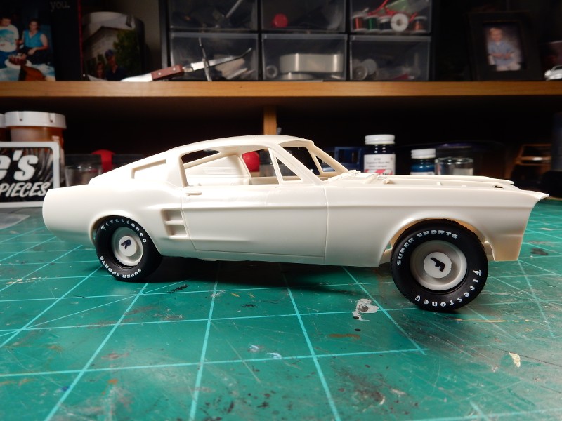

    Well .....given the fact that I've built one of these somewhere around 15 years ago and I remembered that the stance was a nose high look.......I decided to do a mock up to check everythign out and it was just what I expected.....it has a nose high look to it. I have a spare AMT GT-350 in the stash so I cut the necessary sprues from the trees and mocked everything up just to check. Man.....there's gonna need to be some fancy footwork to straighten this out if I'm going to get this thing to look like 1.) the box top (which is severely misleading if a builder thinks that this kit will build up just like the picture) and 2.) look like I want it to look personally.
    On a couple of other notes.....
    1.) Pay attention to the attachment wheel retainers (that I have marked "R" for rear and "F" for front. They are different sizes meaning the rear retainer has a larger hole for the axle then the front does for the spindle.
    2.) The box top shows Firestone Wide Oval Tires and the kit has these Super Sports instead. Not a game changer but hey.....put what's ON the box IN the box. C'mon!!! Same goes for the stance. Just sayin'. [​IMG]

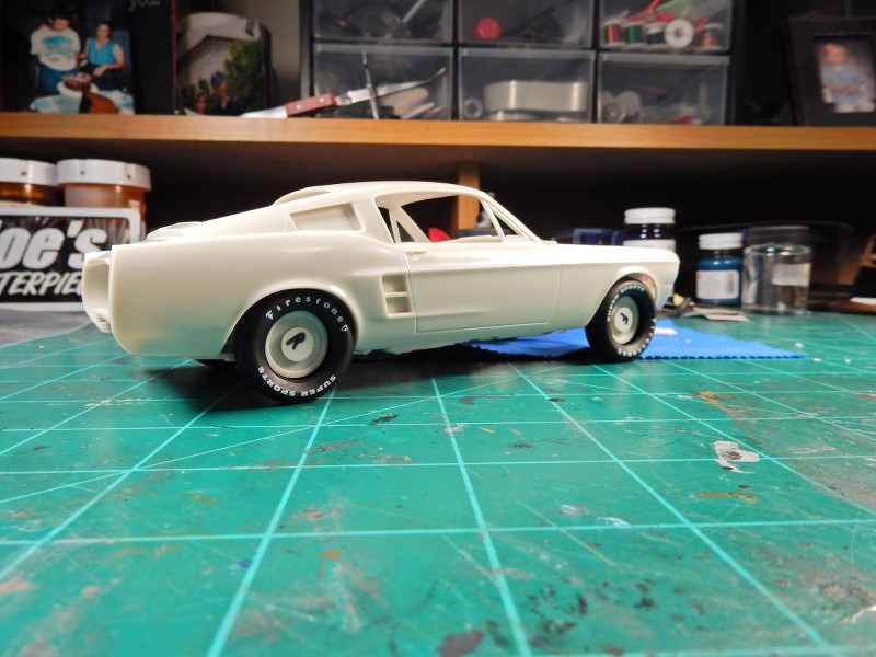

    The OOB stance:
  15. Mavman72
    I have built a few of these kits Joe...I just make my own rear springs to raise the ride height. Or you could cheat and just make extensions for the shackles and raise it up that way...
    Mustang1989 likes this.
