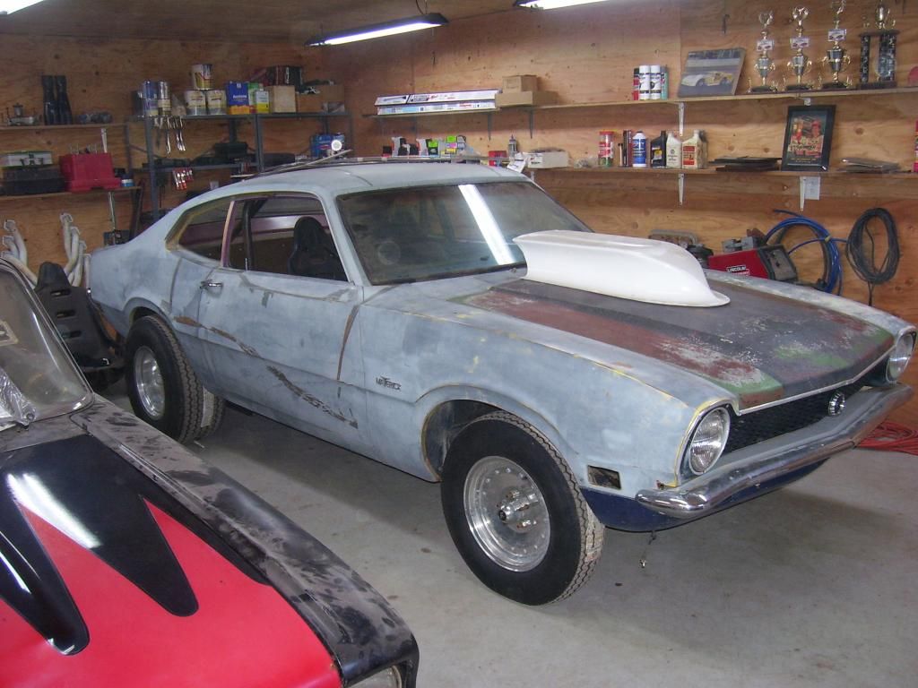

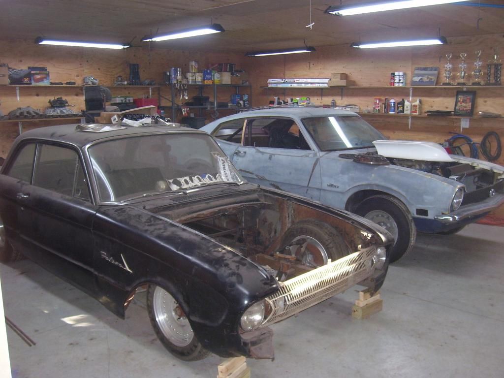

    Here's my Falcon. Also a shot with the "new" right front fender, hood and front valance.
    "Early" Pro Street Maverick tribute car, from the beginnings of Pro Stock. It shares space with the Falcon now.
    Gotta have fun!
