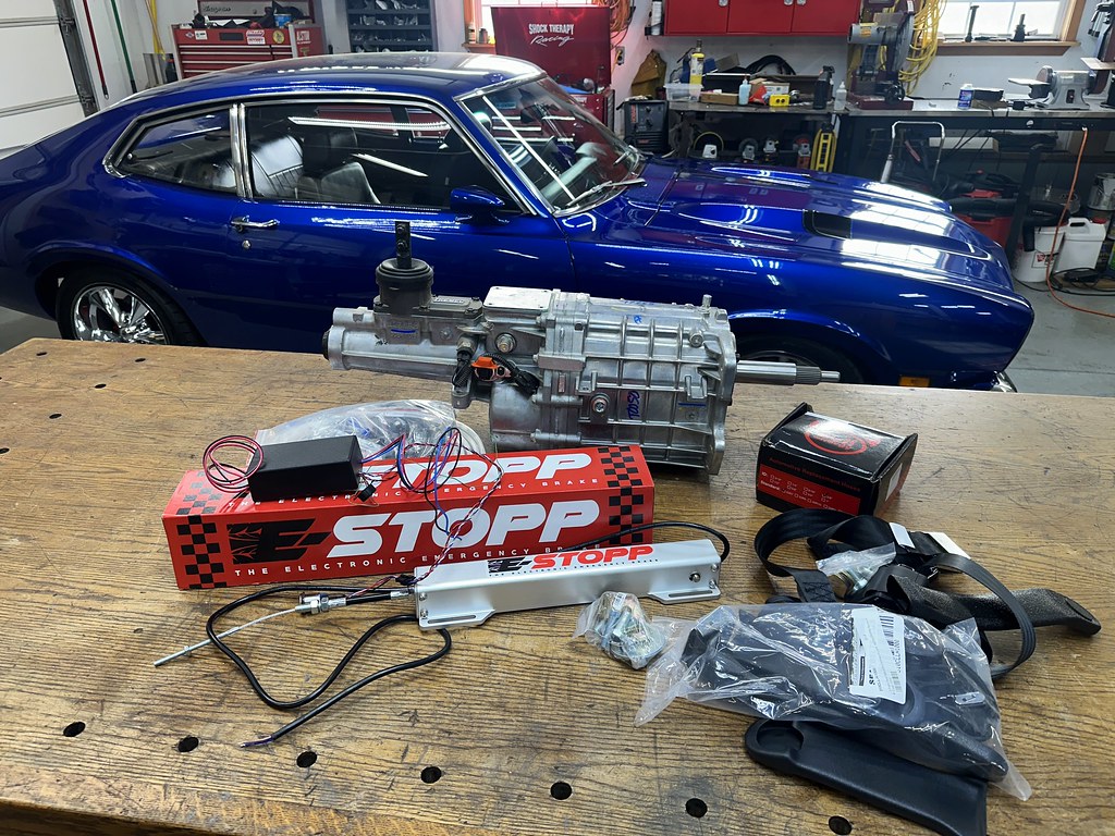

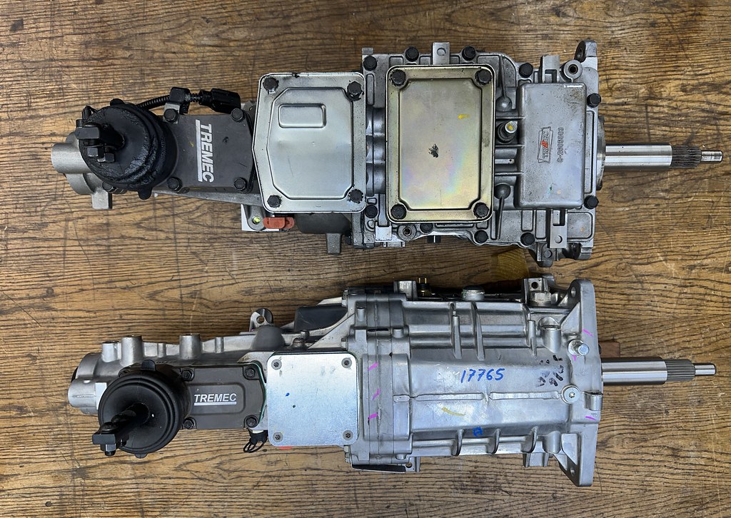

    Biggest is swapping the Tremec TKO for the TKX. The TKO is just to tight in the '69.5 tunnel. Tremec says we are starving the front of the trans because we can't get it any higher than 5.1° down. The TKX should solve that without cutting the tunnel...I hope.
    Moving the Lokar parking brake handle and installing the E-Stop electric parking brake actuator to run the Wilwood parking brakes to free up space in the tunnel for the driveshaft. Still trying to figure out where to put the unit. Not much room for anything under the car. Perhaps in the trunk. Perhaps on the back seat braces. Beats me at this point.

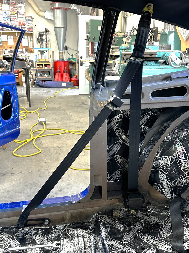

    Installing 3 point seat belts. Still need to figure out the mounting for the retractor. Dread cutting a hole in the perfect headliner for the pivot.

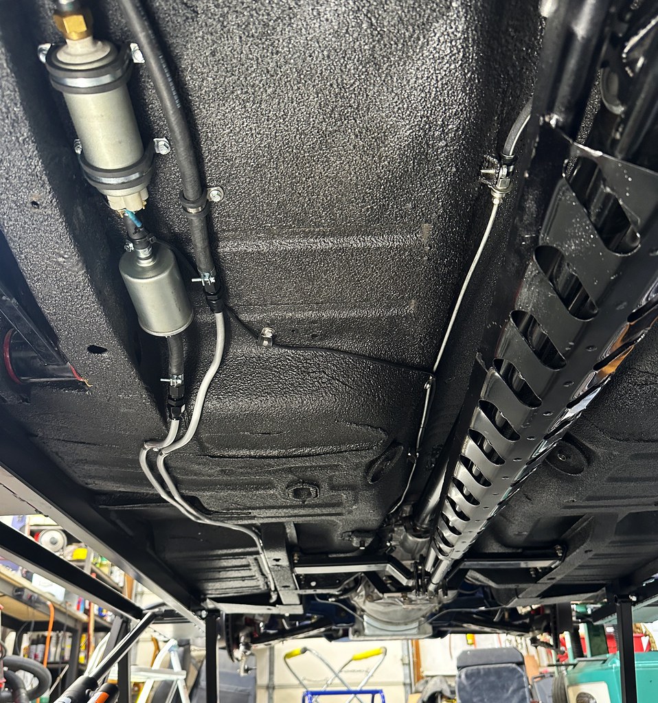

    Rerouting the fuel and brake lines to get them away from the tunnel. Still scratching my head on the route for this stuff also. The car has all RRS suspension including the 3 link rear with a torque arm so there's a bunch of stuff in the way.

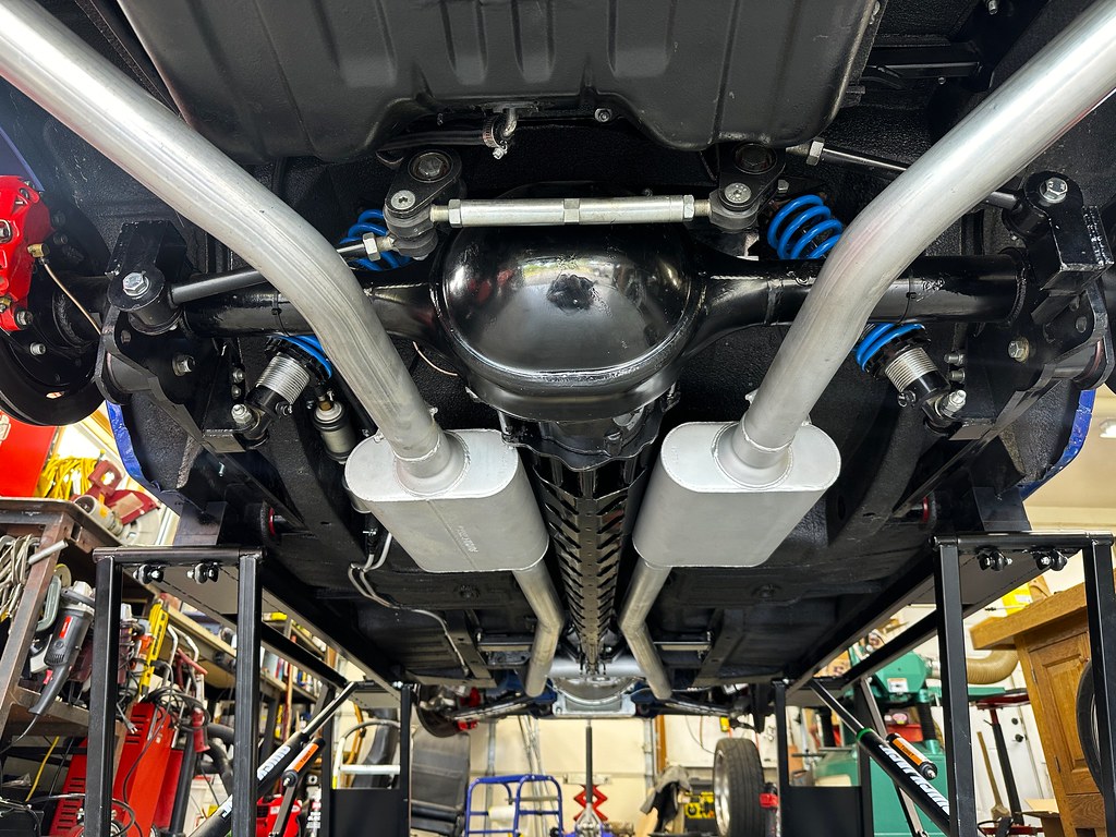

    Got the TKX in. Mission accomplished on it clearing the tunnel and I was able to space the tail 1/2" higher than it was which helped the engine/trans angle tremendously. Unfortunately that caused the exhaust to be right against the torque arm crossmember but a trip back to the exhaust shop solved that. Like the TKX way better than the TKO. Much better shifting and significantly quieter. Was able to sell the TKO to a fellow Ford guy so all good in the end.
    TKX is WAY smaller.

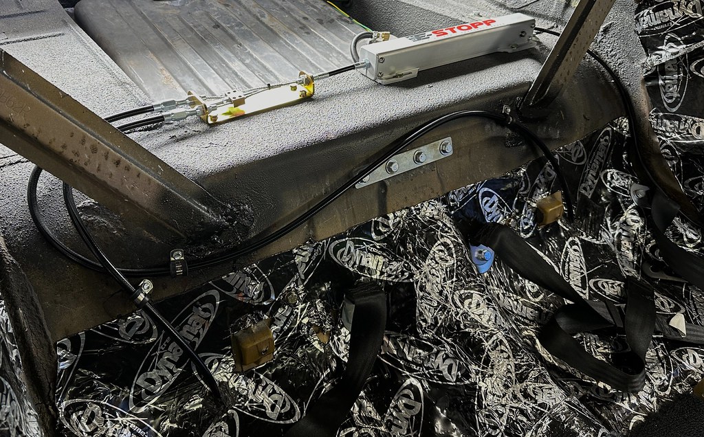

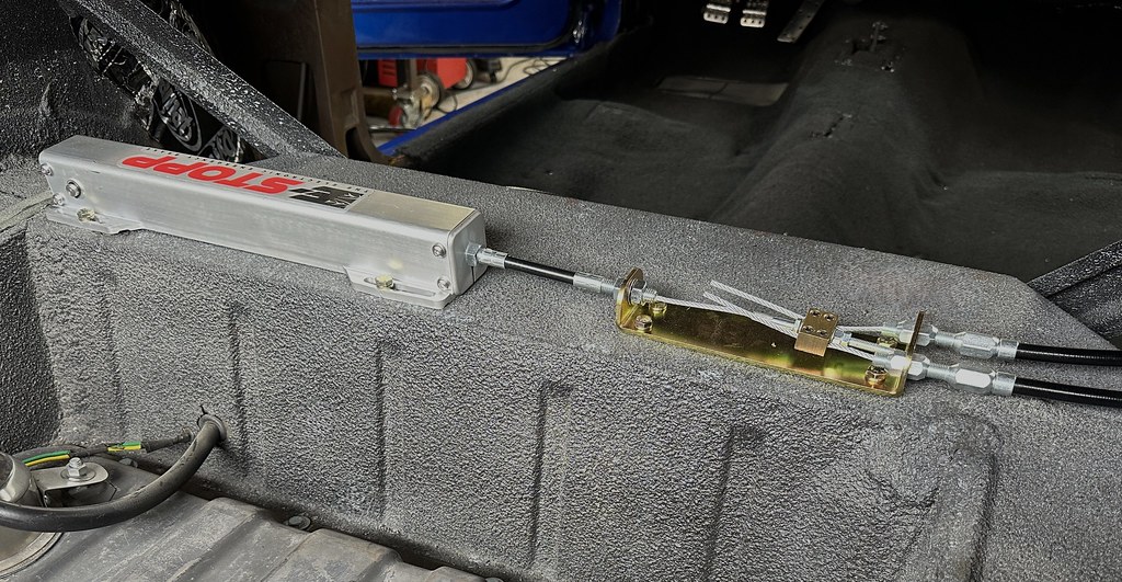

    Moving the tail shaft up also meant that I would have to do away with the Lokar park brake handle that was mounted on the tunnel for drive shaft clearance. Swapping in the E-Stopp was a fairly simple deal. I placed it right behind the back seat. I put nutserts through the floor and bolted it right up. Bought a new cable set as the left cable was too short to working this configuration.

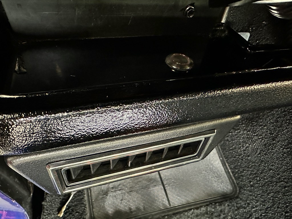

    Mounted the button in the dash tray. Convenient spot was to hide it behind the Vintage A/C duct.

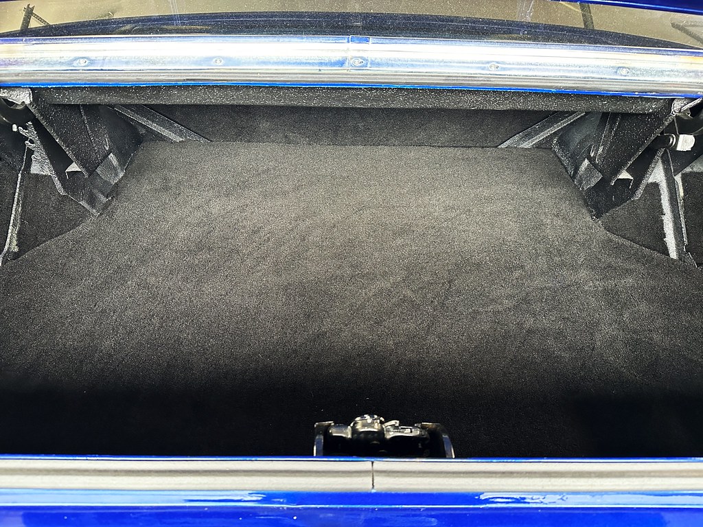

    The car has a custom raised floor in the trunk and it went right back in over the E-Stopp without a single modification. You'd never know the E-Stopp was there.

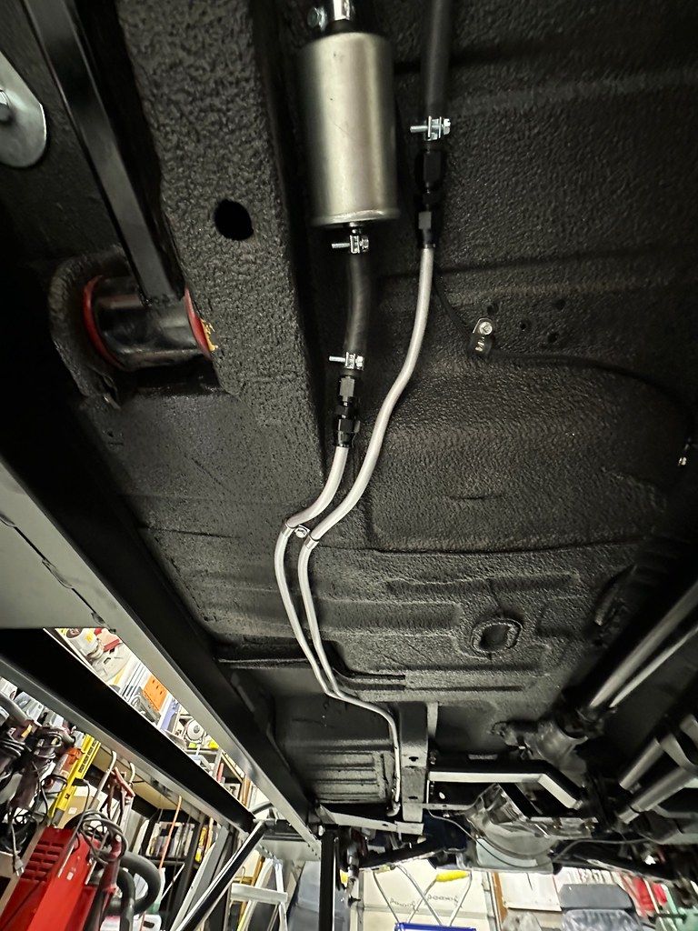

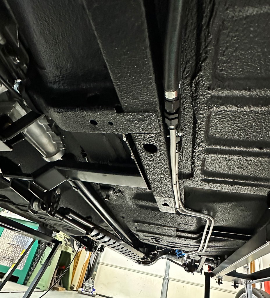

    I revamped the entire fuel system. Moving the pump and filters and running all new lines. Glad to get them out of the tunnel where they were before. Reran and got the rear brake line properly mounted along with redoing the wiring to the fuel pump. Pretty pleased with how it came out.

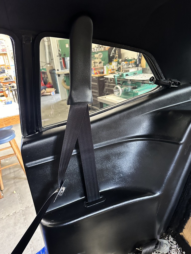

    Next up was to convert from the lap belts to a 3 point retractable set from Seatbelts Plus. I figured out that there was just barely enough room to place the retractor behind the quarter interior panel.

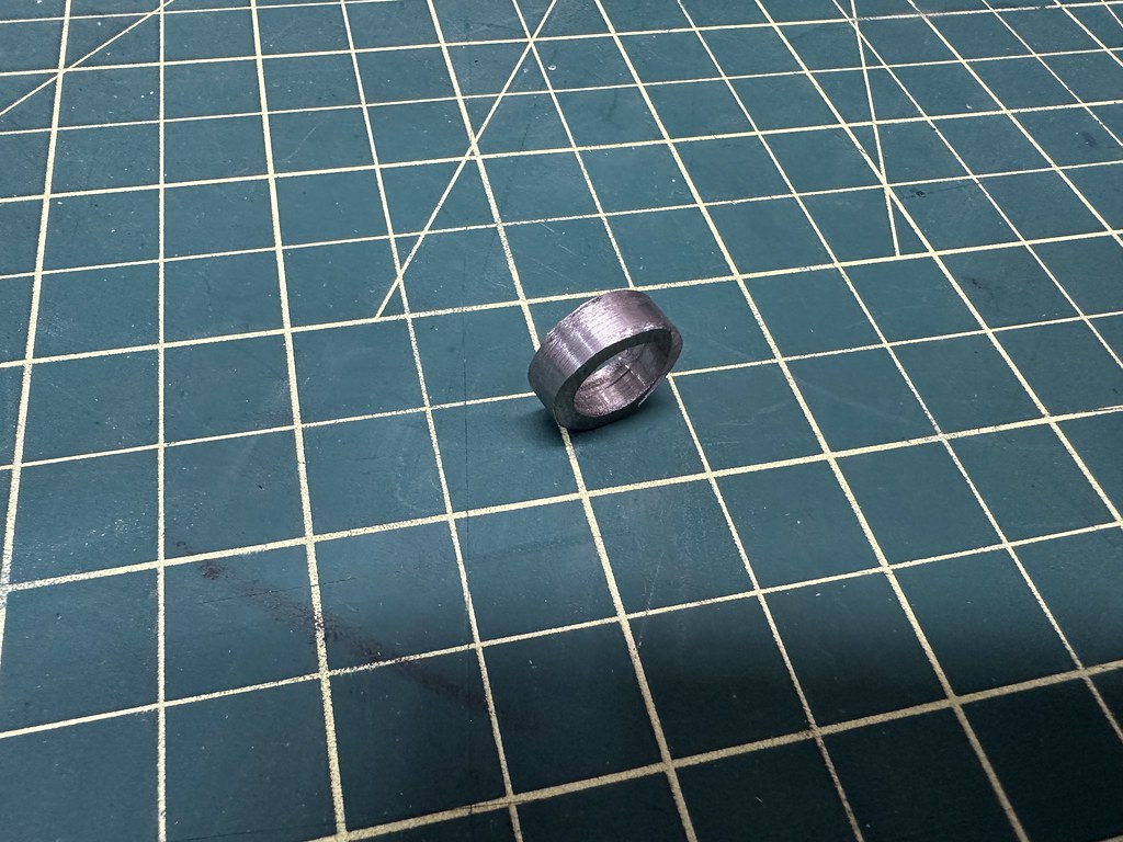

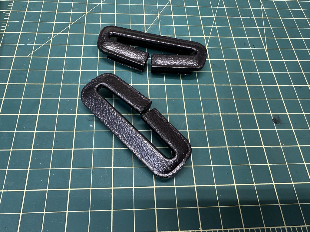

    The upper bung in the early cars is a weird 3/8-18 thread vs the standard 7/16-20. There should be a shoulder bolt there so the upper point can pivot. I ended up making a 3/8 id x 5/8od bushing 3/16 long to make it work out.
    I cut holes in the interior panels and used a couple of seatbelt pass thru bezels left over from our King Cobra build to finish them off.

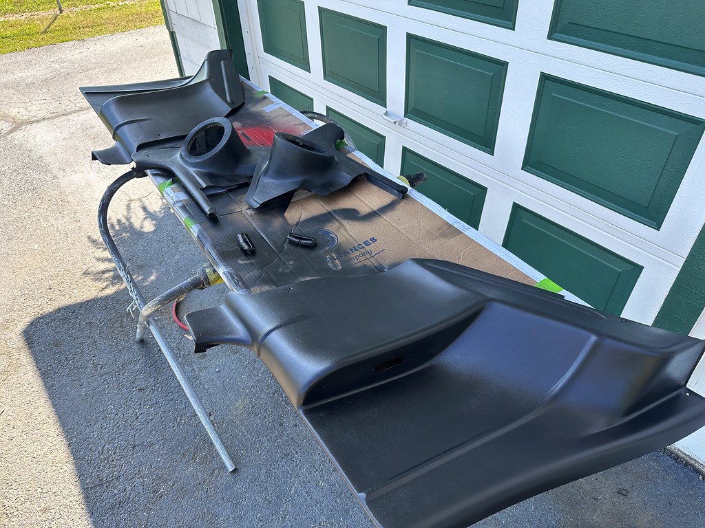

    I reverbed and refinished the interior panels and the kick panels while I had them out.
    Super happy with how the belts came out.

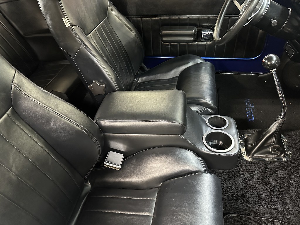

    Simplest of the upgrades was adding the Humphugger console. Snug fit between the ProCar buckets but it works and looks like it came that way.

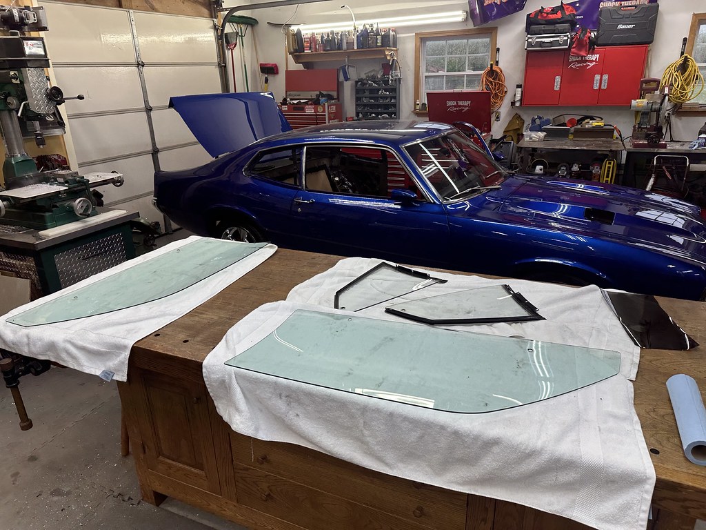

    Last of the projects was to get the windows tinted. I removed the door and quarter glasses and convinced my friend that does mobile tint work to do the windshield and back glass with them in the car. :)
    Love the look. It's 20% on the sides and back glass with 70% on the windshield with a 20% eyebrow.

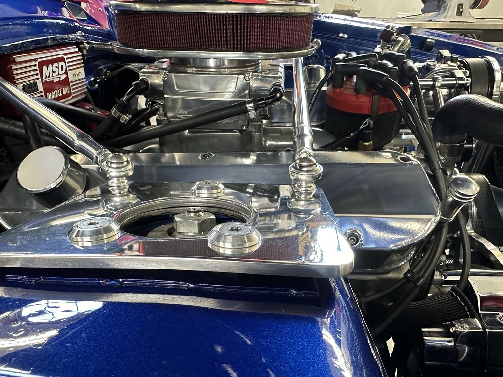

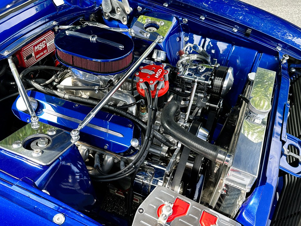

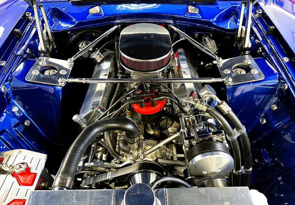

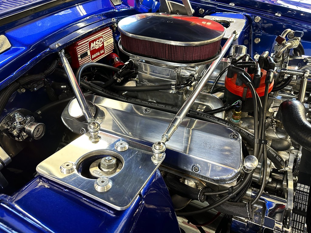

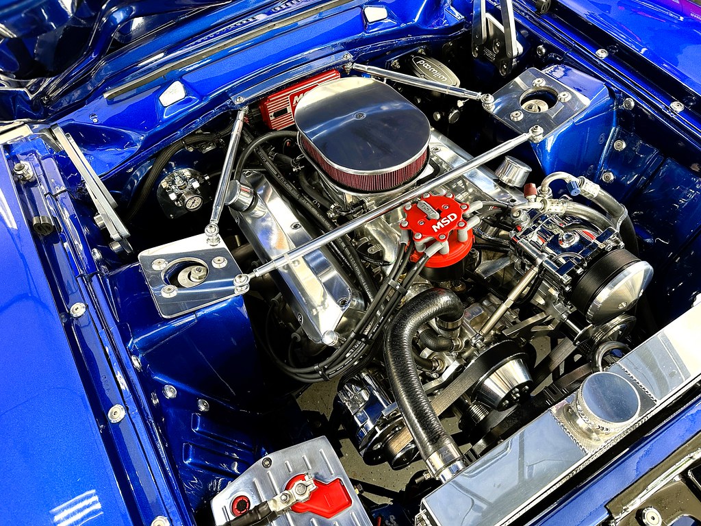

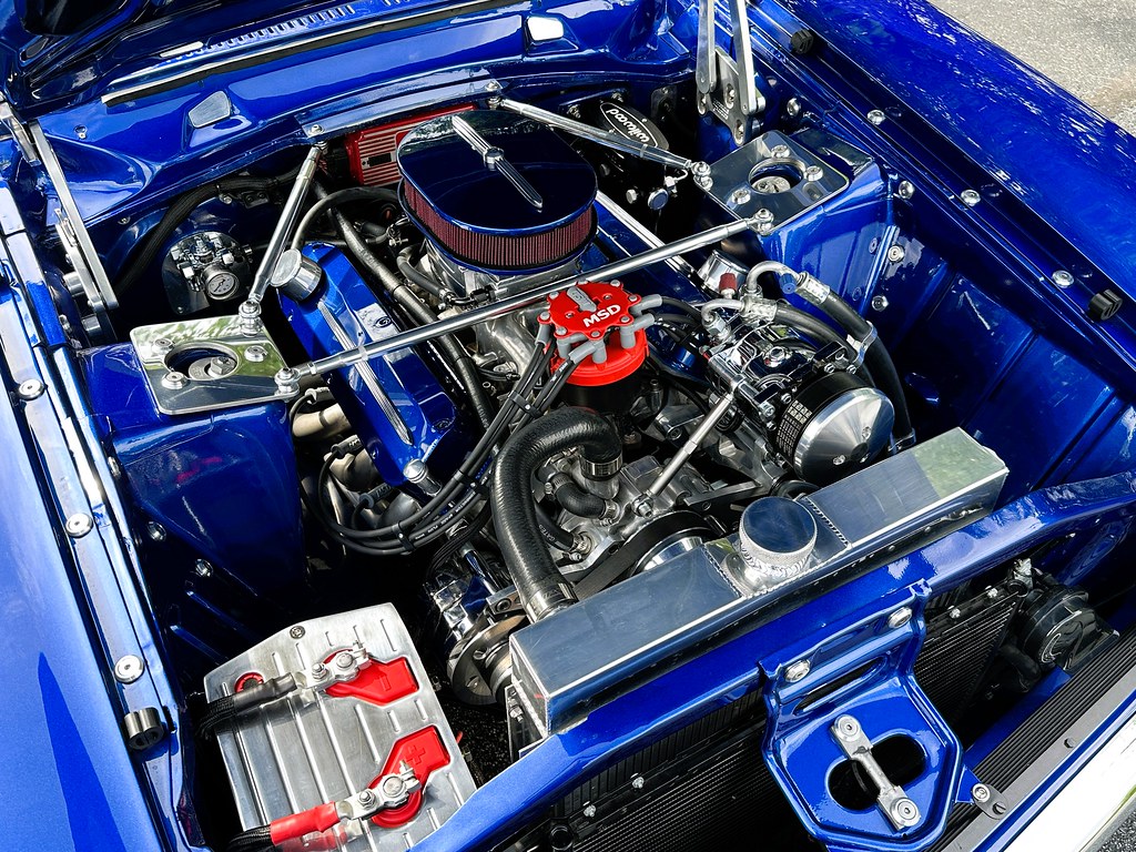

    Finally finishing up the strut tower brace project I started a good while back. The towers are notched and have some reinforcement. Guess they thought that was good enough. The guys at RRS suspension were pretty adamant that the car needed bracing so I fabbed up supports from the firewall to the towers and across the towers. Thankfully enough room to fit the swedged rods between the Sniper and the distributor. The swedged rods, heim joints, spacers and nuts for the rods from Speedway. Couple chunks of 1/4" 6061 off Amazon and a bunch of stainless bolts and such from my local bolt and screw supply.

    Think I like your version of the brace a bit more than what I have. Should be stronger too!

    I would have done one like yours but the A/C compressor was in the way. After some head scratching I finally realized that there was enough room to fit a bar between the Sniper and the distrubutor.

    Finally got around to making up the new MSD 8.5mm plug wires today. I hate making plug wires but it looks so nice to have a set of wires that fit. The multi angle boots are nice. Cylinder 7 and 8 are problematic with the Patriot mid-length headers. These clear nicely. Cool to finally have the MSD retainer on the cap as well. Sme days it's the snall stuff. :)

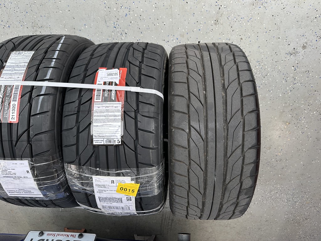

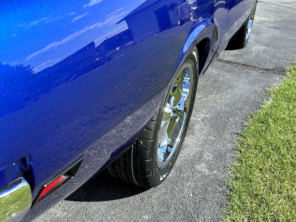

    Playing in a world of high dollar custom wheels and 315's, here I am trying to make 255/45-17's work on the rear of our junk with the wheels we have. 17x8's with 4.5" backspacing is definitely not the right wheel for this car but here we are. 1/4" billet spacer and the 255's clear the inner wheelhouse and fill up the wheelwell opening better. Much happier with how this looks.
    Heartbroken that I just couldn't make these 275/40-17's work with the wheels I have. Here next to the 245/45-17's that were on it.

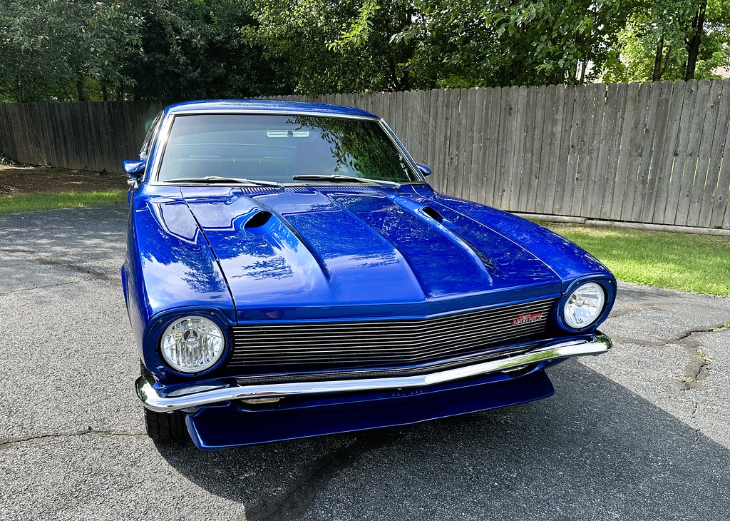

    Anyway, also have a bunch of stuff pulled and at one of my buddy's shops getting painted body color. Guess we'll see if this is a smart move or not in a few days.

    Thank you for painting the hood scoops body color!!! One of my pet peeves when I see them painted entirely black.

    I'm with you Craig. I've never liked the black nostrils. It's been a bit of a challenge to get a match for this color but hopefully we have it now.

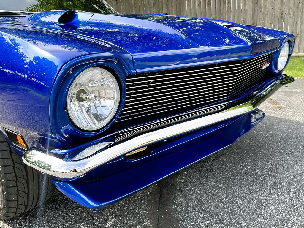

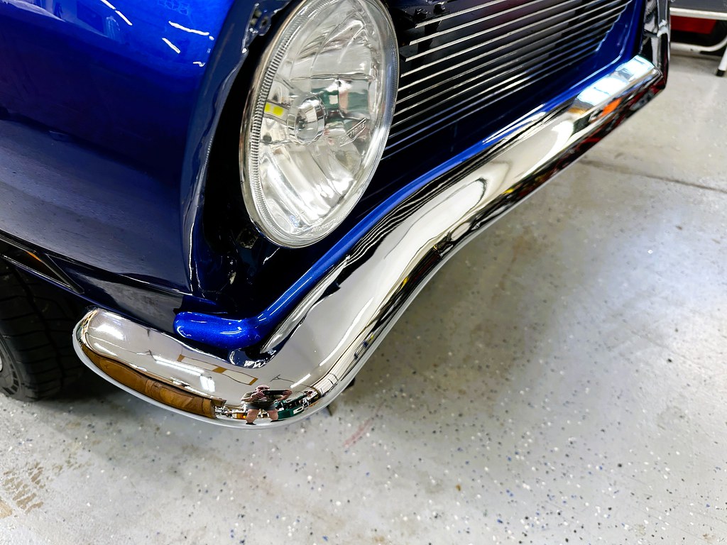

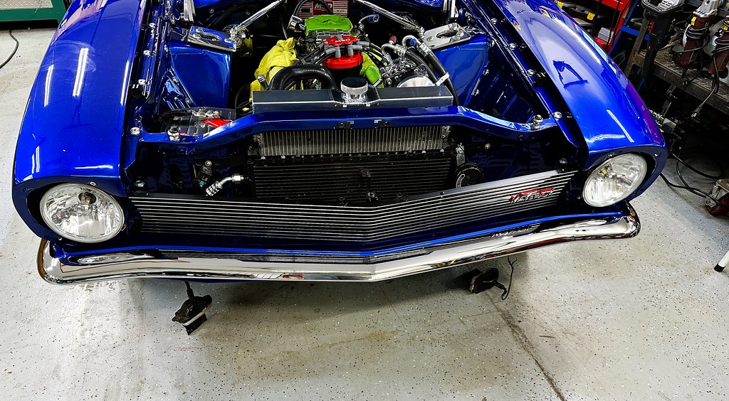

    Obviously it was unseen in the photos but the front bumper was a really bad rechrome job. Replaced with an ACP repro from eClassics. Really nice piece. Fits well and the chrome is super! Now pacing the floor waiting on the painter. lol...

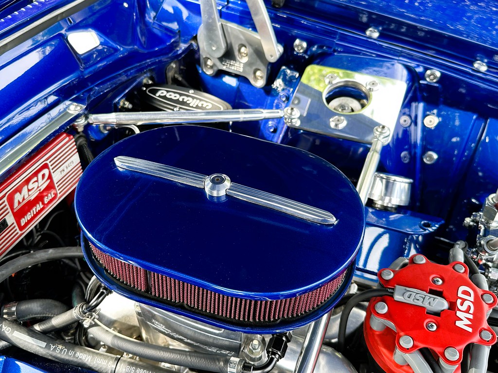

    '70 Maverick Pro Touring. '78 King Cobra restomod.

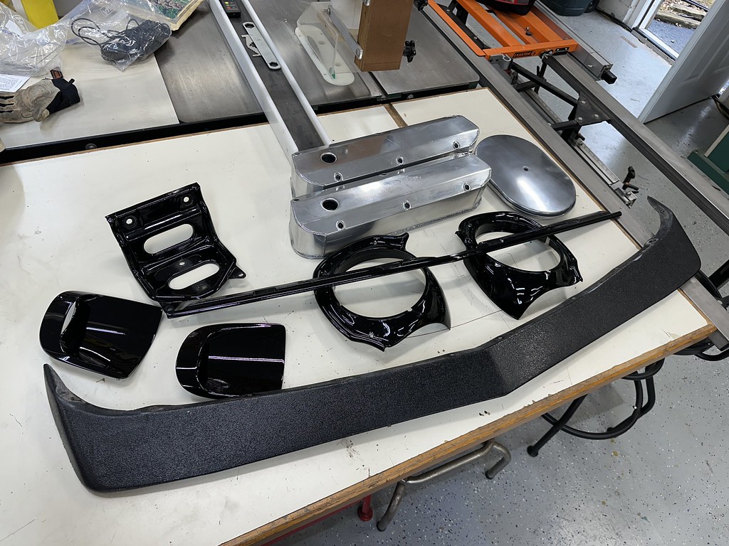

    Parts are back from paint and on the car. I fabbed and polished the new spears on the now body color valve covers and air cleaner from aluminum interior molding I found on Ebay. Color matched the black headlight doors, hood molding, hood nostrils and hood striker bracket. Also smoothed out the texture on the black front spoiler and did it body color. Hood latch and striker redone with stainless steel paint. Super happy with how all this came out.
