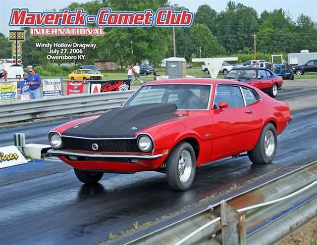

    Running tubes or not really depends on each individual car's setup IMHO. You DO want a little rinkle in the tire like in the picture Mike showed.
    The tubed slicks will also wrinkle. Here's a shot of my launch at Windy Hollow:
    Judging by the foot print of the tire in this picture, it appears I had too little tire pressure (it looks like the center part of the tire wasn't gripping as much as the outter part).
    I chose to run tubes for a couple of reasons, 1) I was constantly having to air up the non-tubed tires (didn't know about the dish soap trick), 2) Consistancy at track, 3) Safety: Running a tube is simply safer than running without one - with a tube, there are two seal barriers, the tube and the tire. In the event of a blowout at 100mph+, that 1 second might be enough to help correct a potential disaster.
    Having said all that, (here comes the qualifier), a car will generally turn quicker e.t.'s withOUT said tubes ("unsprung weight" thing - read HERE.
    I believe it comes down to a matter of personal opinion based on individual variables.
    Oh, and dkstuck gave some good advice I'd fogot to mention when it comes to tire pressure. Have a buddy look at your tire's "foot-print" after you launch to see if you're getting too little or too much contact with the track.
