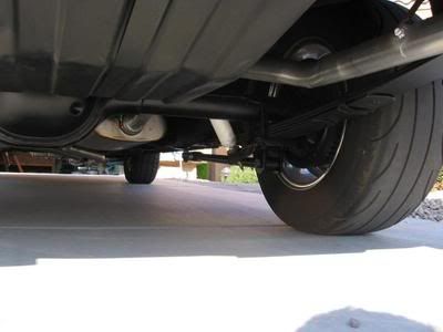

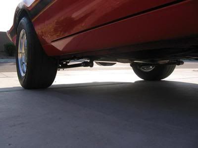

  3. Gene Fiore
    Gene Fiore Member
    Nov 8, 2005
    1,878
    148
    Goodyear, AZ
