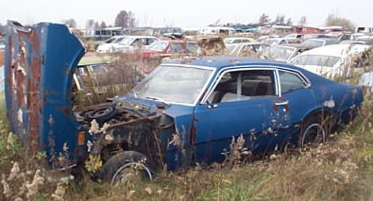

    This was one I saw in a junkyard.
    Lots of thought went into making this tilt front-end....as well as a lot of bondo and reinforcing shelving brackets.....NICE!!!

    I remember seeing that in your Maverick Heaven page long ago. I couldn't imagine trying to mold the fenders to the hood with bondo and not having them crack the first time you hit a pothole, if that is what he used all the bondo for :cry:
