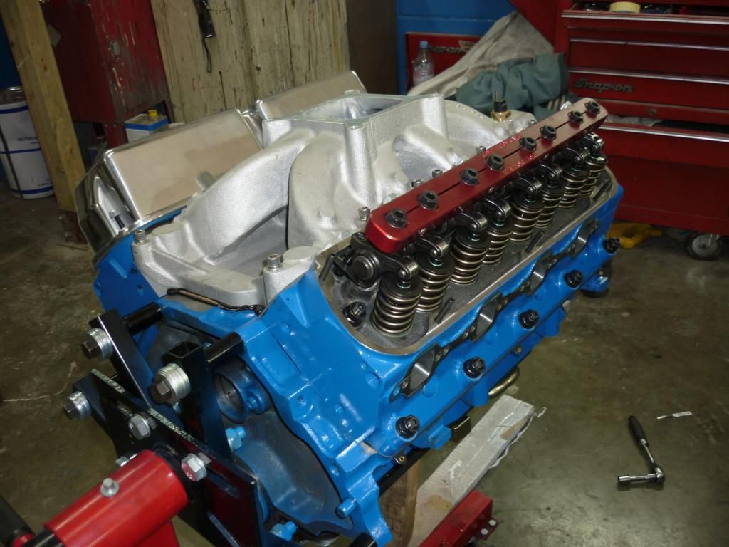

    Nice start, are those Windsor Jr. or Sr. heads?
    What are you doing with the rest of the motor?

    The heads are RHS with 2.02-1.60 valves, Stroked to 347 with a steel crank, eagle H beam rods, Forged pistons, Special grind Crane roller cam, Mcleod aluminium flywheel, 1.6 ratio roller rockers, Edlebrock victor junior and a few other minor modifications on the way :)

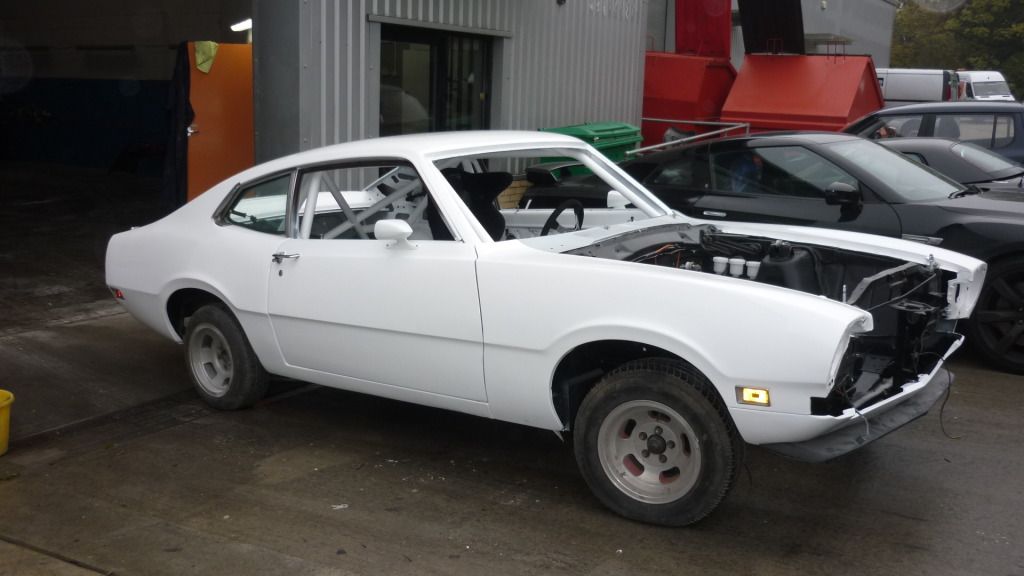

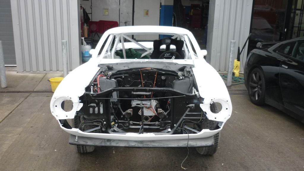

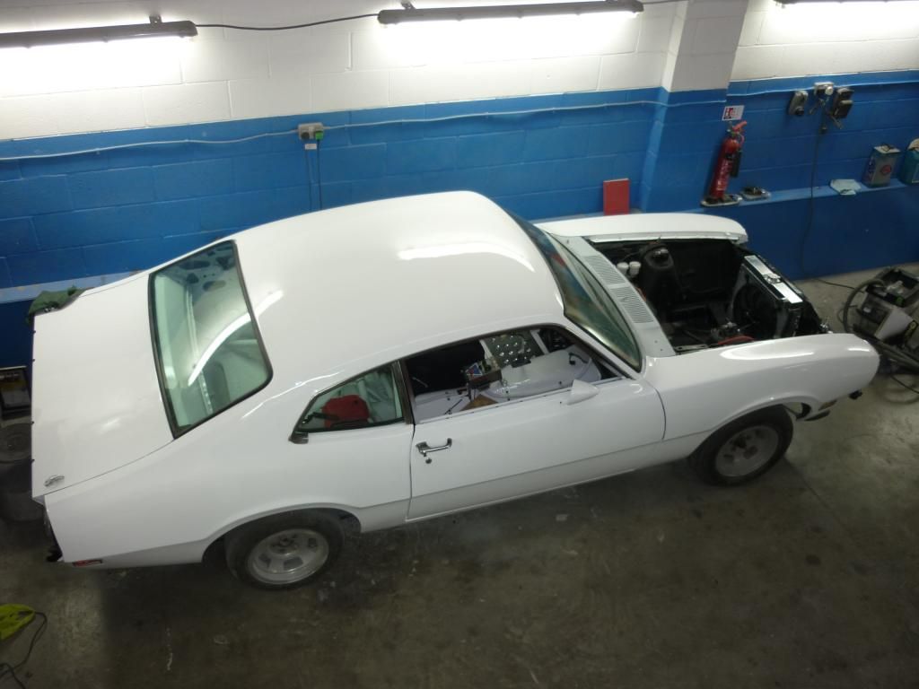

    A few updated pics since paint :)

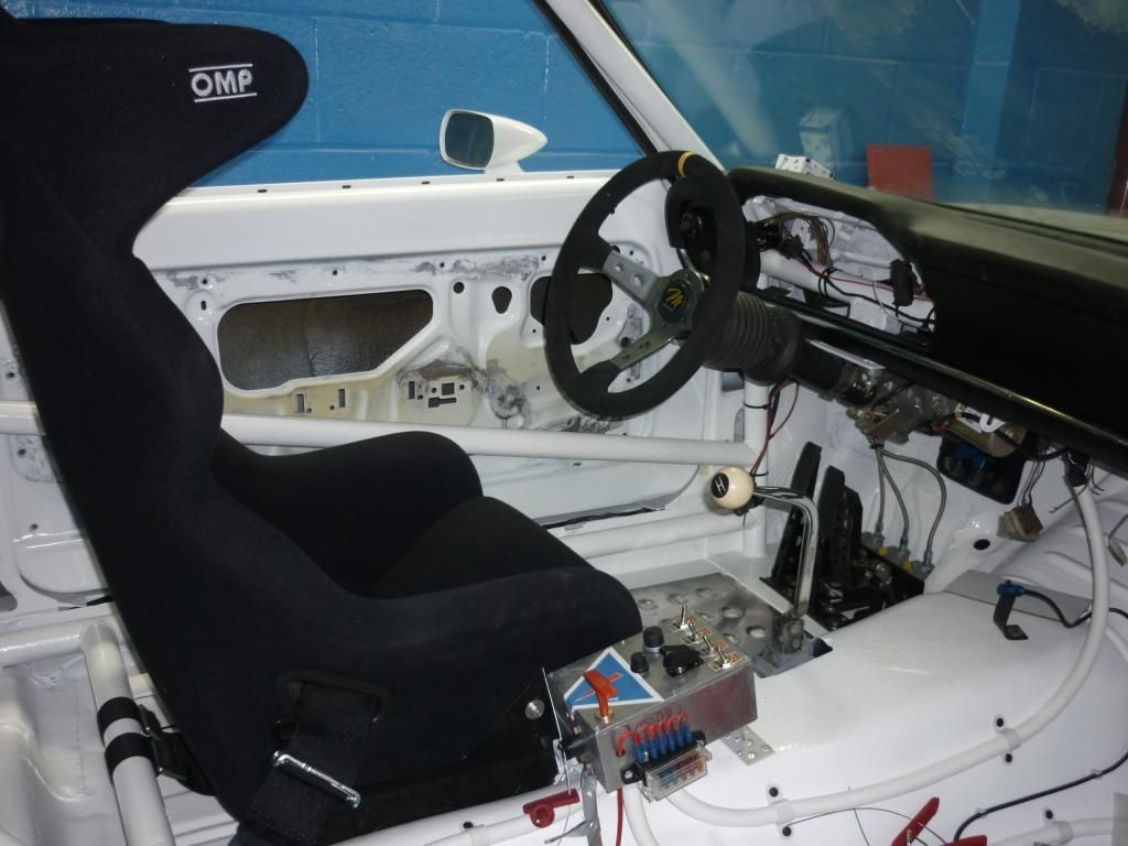

    Inside picture missing dash as I have not finished that yet

  6. olerodder
    olerodder Member
    Nov 22, 2009
    2,983
    NorCal
    I have always loved white..............the interior looks so sanitray...........can hardly wait to see more pictures, fantastic job:bowdown:

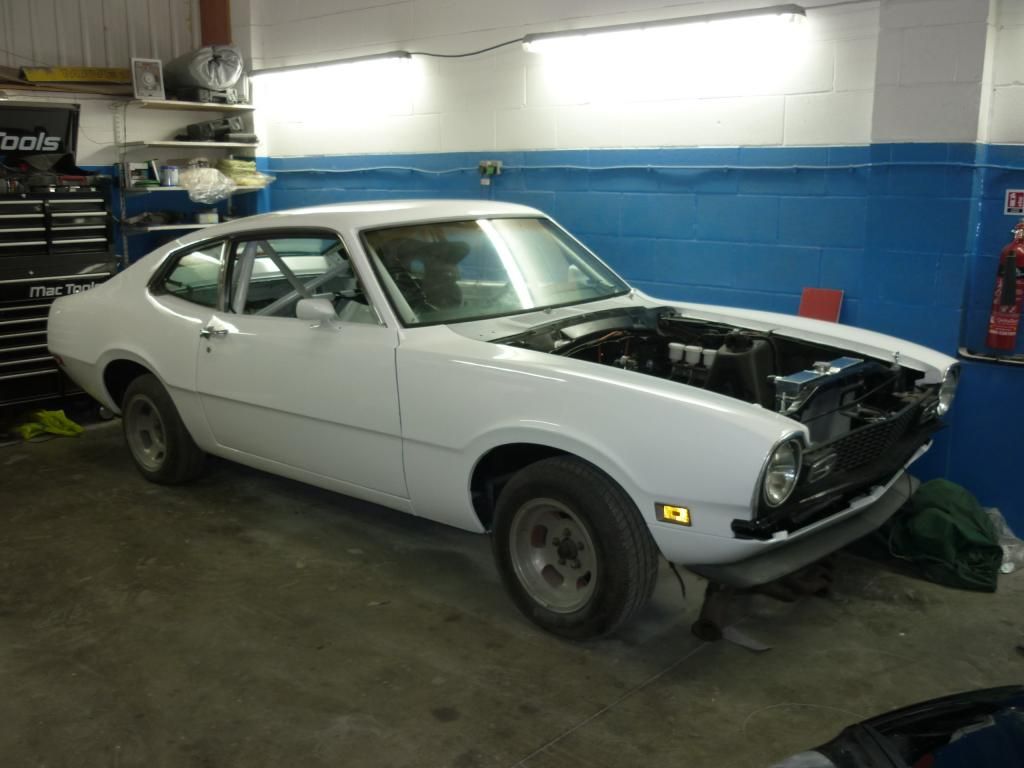

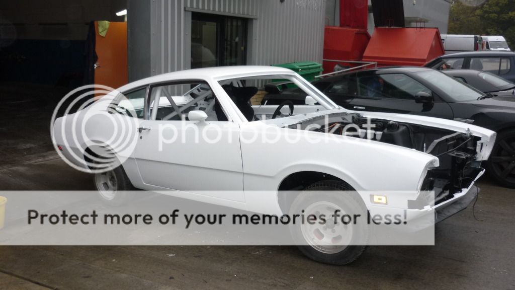

    Getting there now

  10. Streamliner
    Streamliner Member
    Mar 4, 2010
    578
    Nice...Right up my alley
  11. mavgrab302
    Awesome... I love those peddles you have mounted to the floor....

    Very nice and I really like how you've tucked the slave cylinders reservoirs behind the shock tower..................................well thought out!

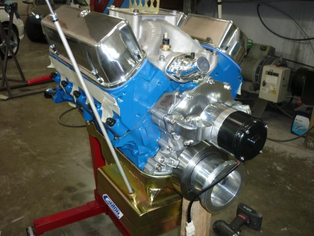

    Power plant finished and ready to fit
