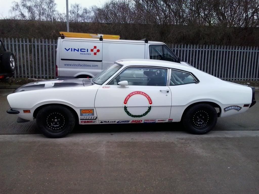

    5 weeks till the first race

  11. mavgrab302
    Looks Great... I think it's going to be a big hit at the races. :thumbs2:

    Looks fantastic, when will you take it on the "maiden voyage"?

    Its first real outing is at a race track called Oulton Park, This is the first race of the season but I will have tested it hard before that but I have not decided where.
    I should be running a camera setup on the first race and will upload via you tube for all to see.
