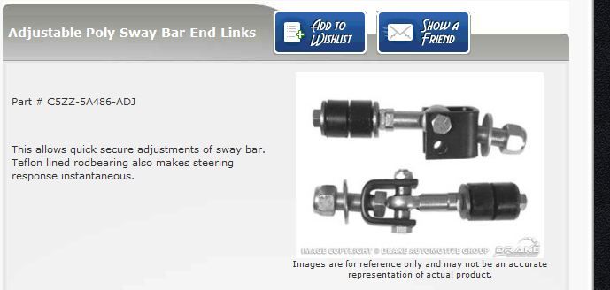

    I was going to put a '76 Granada swaybar on my Maverick today. Once I got them side by side I saw the Granada SW is 2" wider than a Maverick SW...I don't think the swaybar will be able to do its thing. I think it will be pushing sideways more than pushing down on the lower control arm
    Granada (on top) vs Maverick Swaybar (on bottom)
  15. Dave B
    These will solve the problem:
