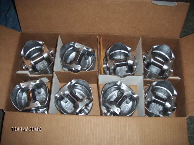

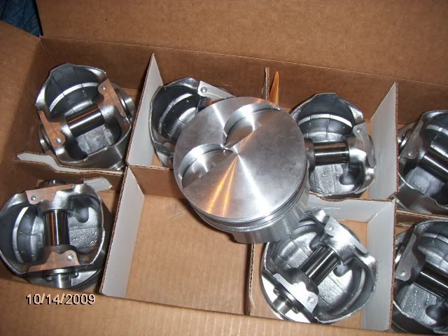

    Don't forget to remove the sharp edges on those eye-brows. Take some time with 120 grit sandpaper and round them off to help prevent detonation.
  3. mean_maverick
    really? ive never heard of that before.... hmmm
  4. PaulS
    PaulS Member extrordiare
    May 3, 2004
    4,858
    Seattle area
    Never heard of sharp edges in the combustion chamber causing detonation?
    Or never heard of taking the sharp edges off a piston?

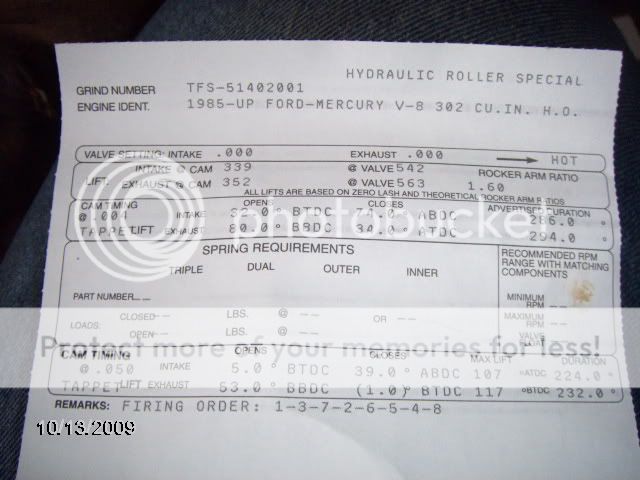

    Daymn! That's a big ole cam! That one should have some lope on it!

    wow big cam that will thump lol......mines lopey with 500 lift and .342 dur.

    never heard of either really... that's good to know
    we shaved them when i first got the car...

    it should smack the ground pretty good, especially with an 11:1 motor :thumbs2: :burnout:
