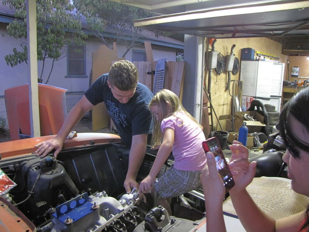

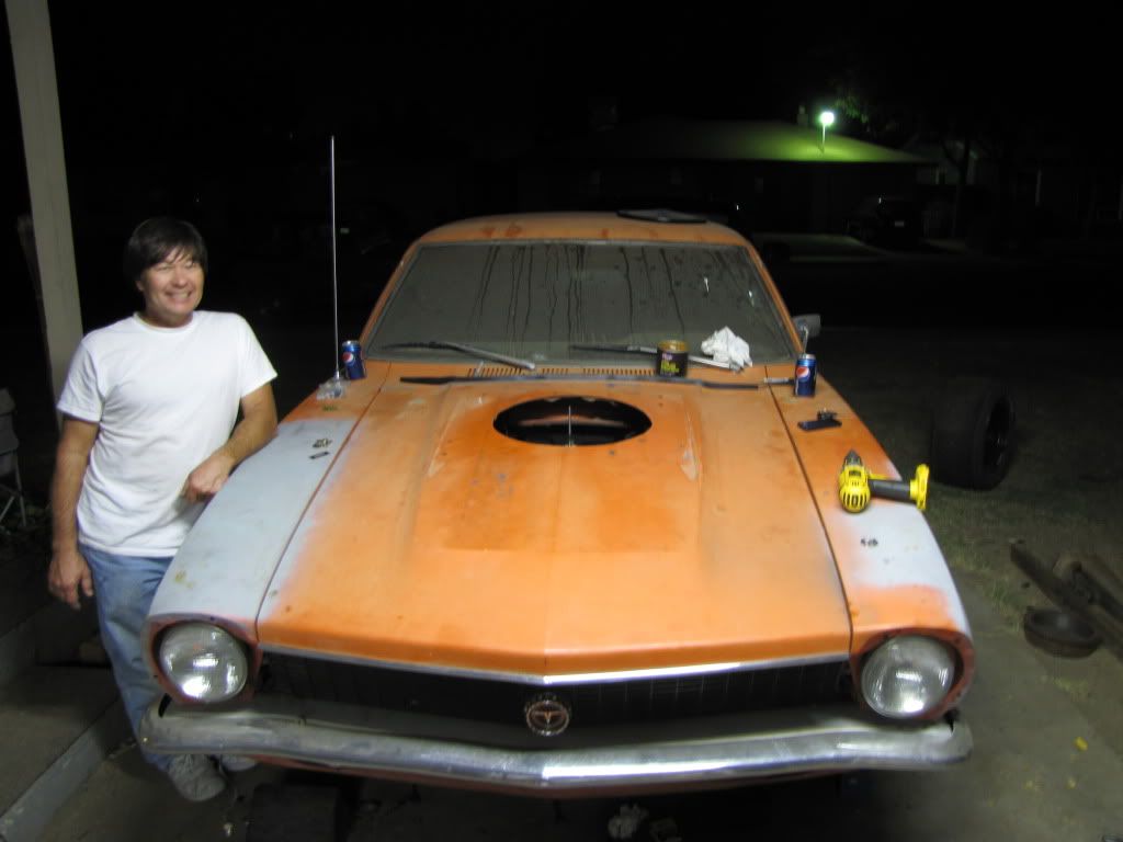

    made some more progress today.got the trans crossmember modded and installed,got the new aluminium driveshaft installed,carb and air filter installed (k&n 14x4 w/extreme lid),cut the hole in the hood (under scoop) for said air filter and well thats about it.now for pics
    had couple helpers today.my buddy ken
    my 7 year old daughter,kayleigh
    she wants to know when she gets one of these for herself. rear fender is just sitting there,not installed
