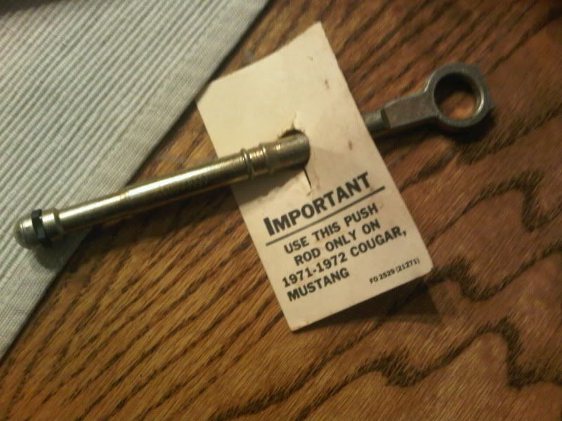

  10. Dave B
    Here's what the tag says:

    DDB, what is the length of that rod?

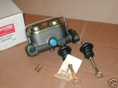

  12. Dave B
    I've got 2 in the box, one is 6 5/8, and the other is 6 3/8. I can't be sure that the tag is suppose to be on that rod, but it's still in the box they came in.

    NJ
    Hmmm, mine is about the same length as the short one. I wonder why my pedal is so high?

    1,392
    That is the two lengths I have as well.
