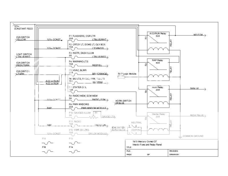

    On a side note, I have also been sketching up my updated fuse and relay box for under the dash. I am adding some more fuses, for accessories, and some relays to take the load off of the ignition switch and horn contacts. I am also adding RAP (retained accessory power), which is what newer cars use to keep the radio and power windows operable after the key has been turned off, until a timer runs out or the driver's door is opened. I will be making my own RAP module.
    Fuses F1 through F6 are the original circuits, with F7 and up being added circuits. I am using the original wiring, so I had to track down the wire colors and their uses. This was done up from only looking at the vehicle schematic, so I am sure I will need to adjust things here and there.
