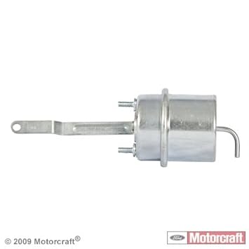

    Ordered some parts that I know I will need for this HVAC rebuild.
    1971-73 Mustang heater control valve vacuum switch.
    New defroster door vacuum actuator that I think I can modify to fit.
