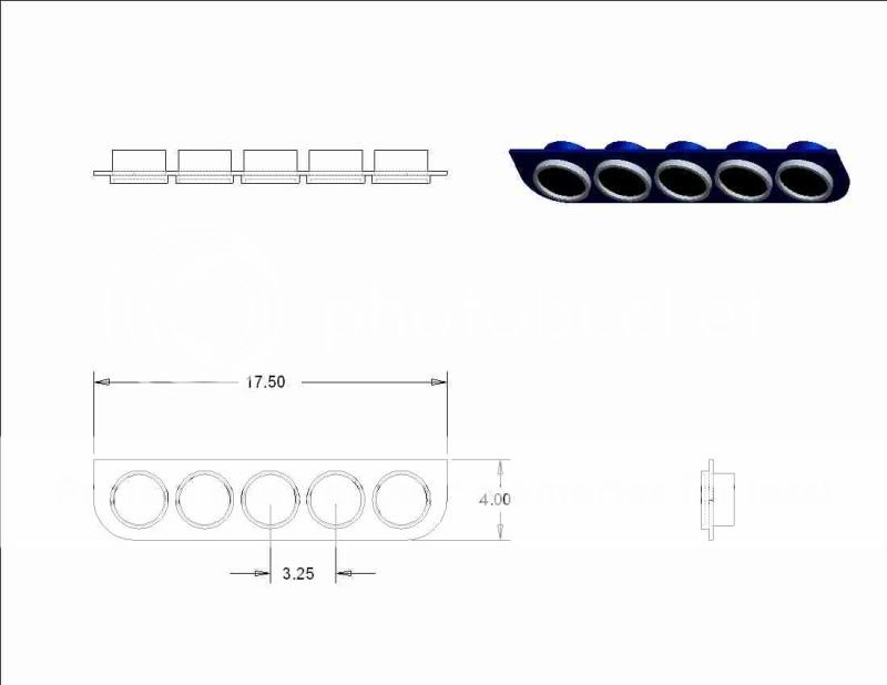

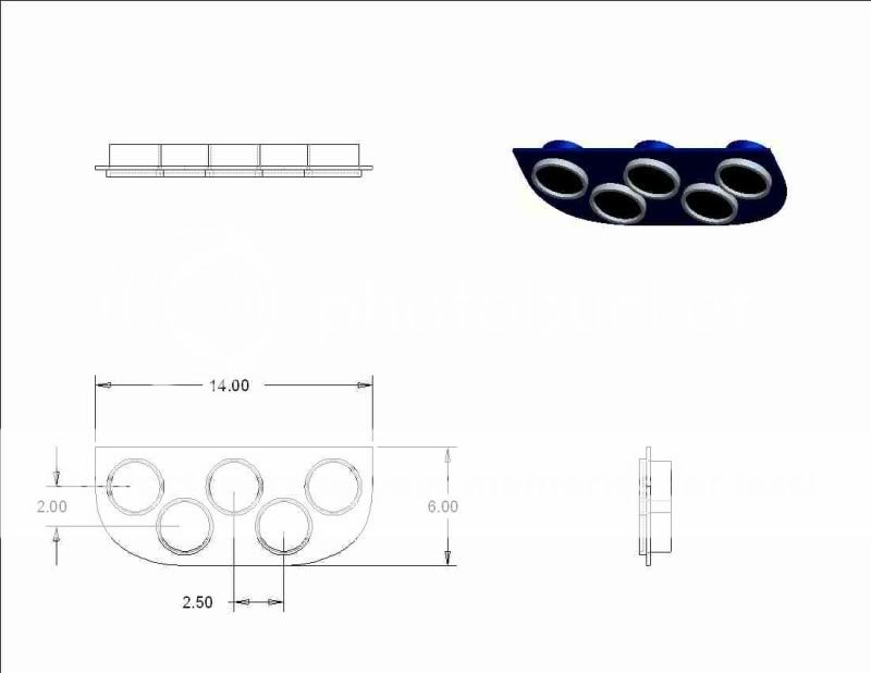

    So I have received my new 2 5/8" gauges, they are awesome. I am now messing with some ideas for gauge panels. Here is my first idea. Its kinda basic, but it would hang under the dashboard, just like a 3 gauge panel would. I still need to CAD an upper lip for attaching to the lower dash. All dimensions are in inches. The panel will be blue and made out of aluminum. My second idea is a staggered setup, with 3 gauges along the top and 2 on the bottom.

    Here is my second design:
  14. mashori
    mashori Member
    Apr 21, 2006
    3,630
    San Diego, Ca
    1971 V8 Maverick
    second design is awesome!
  15. darren
    I second the second design. Oh and I'll take one as well.(y)
