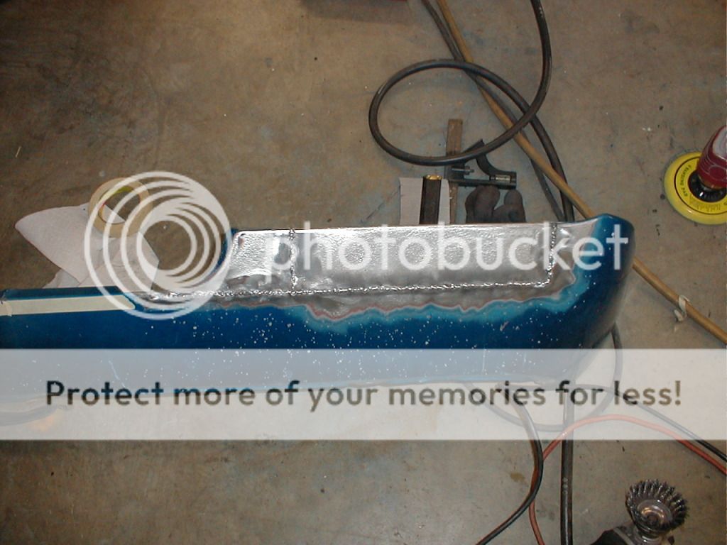

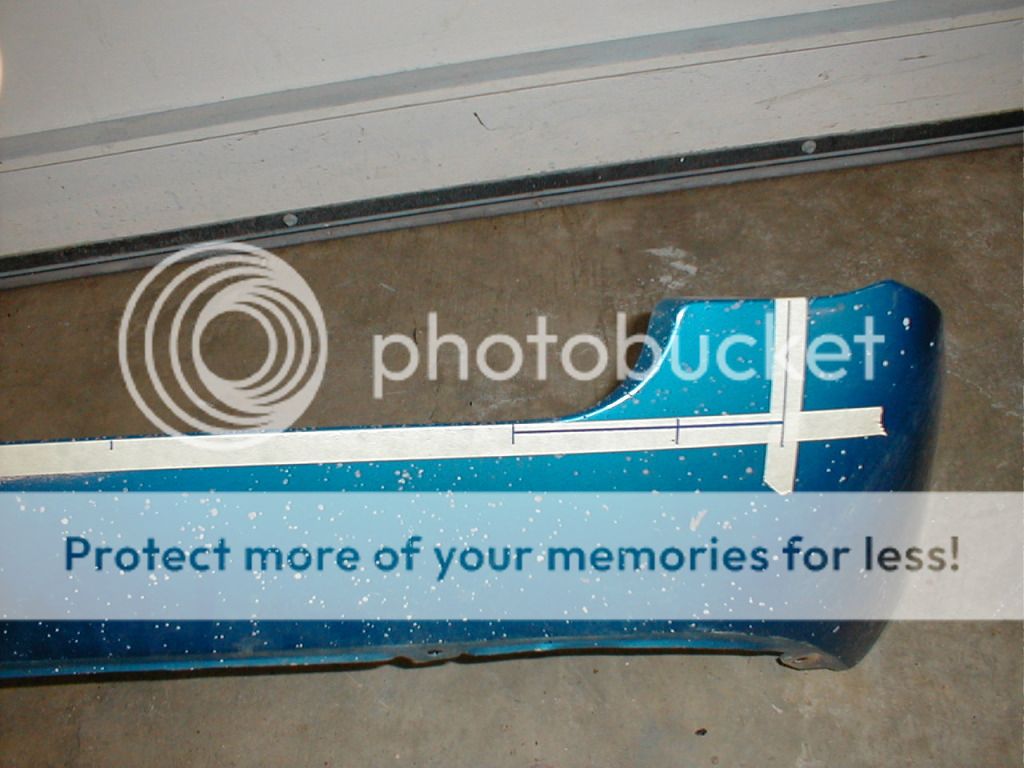

    Front Valance Mod. I stole this idea from Mark Gustavson back in 2000 or so. I had a thread on it back in 04 but the pictures are long gone so I figure I'll add them to my project. thread. The lack of under bumper lights on the Comet makes the opening too wide and dont look right in my opinion. Closing the gap is fairly easy as outlined in the following pictures.
    Layout the curved section to cut out so it can be used further in.
    Determine how wide you want the opening to be and move the cut out section to there. I left the opening the same width as the radiator.
    Tack it in place
    Make a filler piece out of scrap metal.
    Weld and grind and weld and grind.
    The difference compared to a stock piece.
    mavgrab302 likes this.
