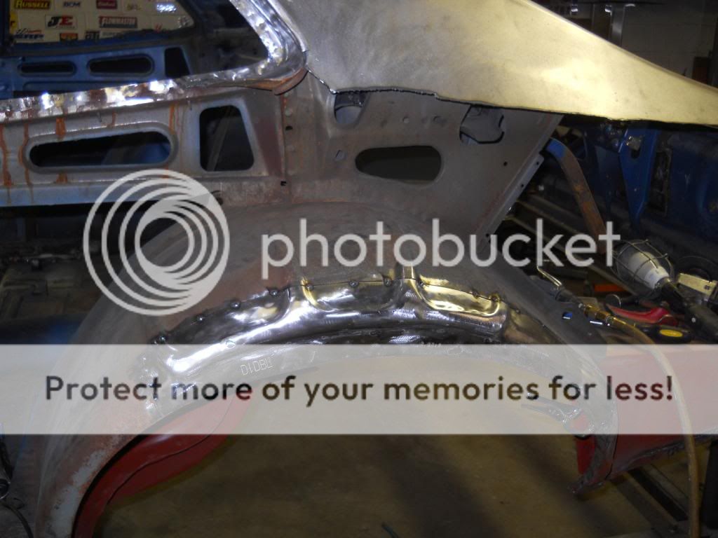

    FInally got the drivers side quarter panel on this weekend. I had already repaired it with these pieces that I cut from another car. But I was never happy with the quality of the metal that was left. Luckily I acquired a bunch of NOS stuff back in 09. Among them was 3 quarter panels.
    So cut the repaired quarter panel off and did a proper repair on the wheel well housing.
    All the inner pieces and structure repaired and treated with rust encapsulator.

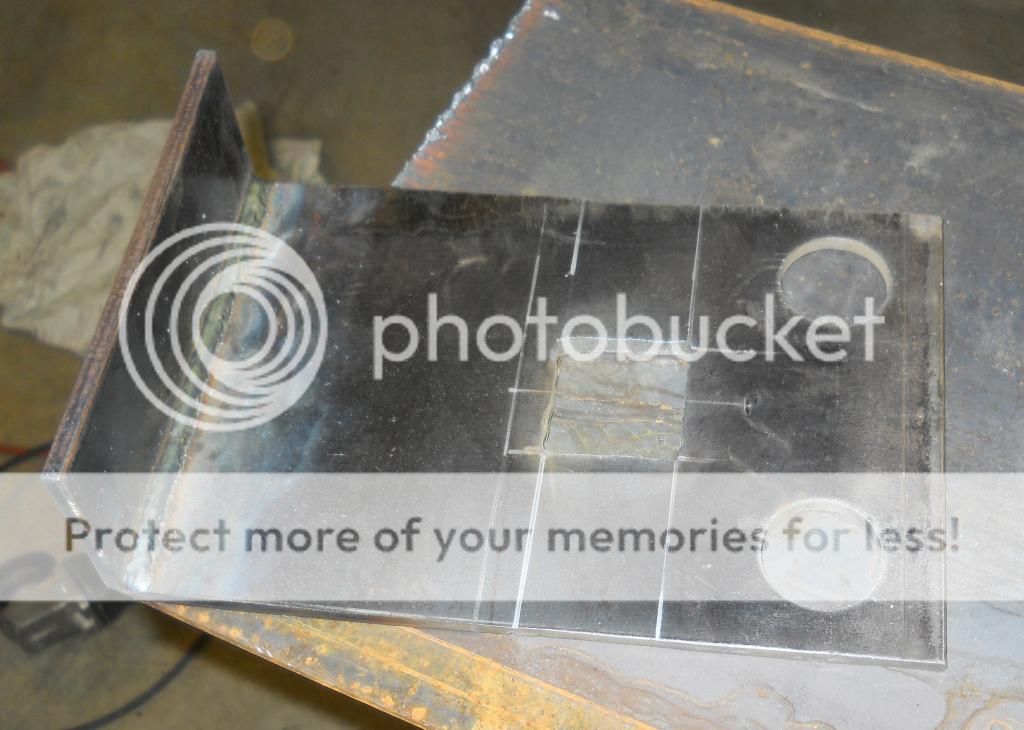

    Building a trailer hitch. Since I plan to use this car as a driver, I want to take my harley on trips with me. So I figured I build a hitch and pick up a motorcycle trailer. I figures max towing weight would be around 1200 lbs. So I picked up a 1 1/4" x 6" receiver tube. They are good up to around 3500 lbs so it is more than adequate for my application. Plus the smaller size is more compact than the standard 2" receivers. I also picked up 4 feet of 12" wide steel, 1/4" thick to make all the mounts.
    First step is to lay out the safety chain holes and hole for the receiver tube. I was originally going to try and bend it into shape but even with my oxy/acc torch, it was too much area. I I had to cut it into sections and weld it together.
    The finished rear mount.
    Next step is to mount it on the rear frame. The rear frame is not perfectly flat. It tapers slightly. Plus you have to put something in there to keep from crushing the rail when you tighten it up. The solution was to make some solid spacers. I had this 1 1/4" steel shaft that I dont remember where or when I got it, but I'm glad I did. Its good to be a pack rat. So I cut off a couple of 2" sections, bored a 1/2" hole, and cut them so they were flush with the back side of the frame rail. Then welded them in. Once the bottoms were welded, I bored the 1/2" hole through the trunk floor. Then I Drilled a 1/8" hole through the trunk floor on each side of the 1/2" hole to plug weld the spacer on the top side.
    The finished rear mount. I will weld the nuts to the mount so all I have to do is drop the bolts through the trunk floor and tighten them down. I will reinforce the trunk floor with a 1/4" plate. I plan on using the holes in the frame that the original tie downs were bolted to for the front mount. They are already reinforced with anti crush sleeves. This way the hitch will be removable in a couple of minutes with only 6 bolts. I will add some gussets to the top of the mount just for over kill.
