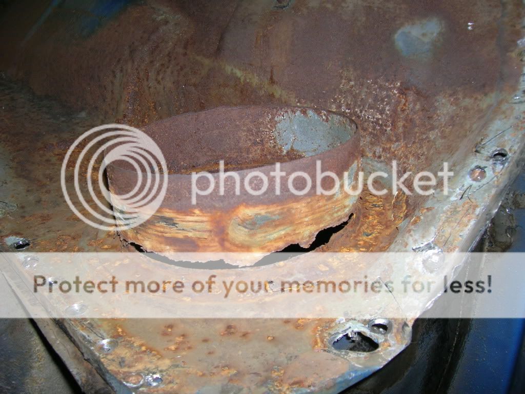

    So basically, you have to seal around that tube and then put the cowl back on right?
    If you seal the cowl solid piece without visible vents, can you run into any problems? I think I may have to do that to my 1973 comet gt. Let me know. Thanks.

    If you are asking if you can eliminate the openings and cover them with flat metal, the answer is yes. They are only there for fresh air. The water goes around the hats and the air circulates over the top of them and into your car.

    You've gone this far .. ( nice work by the way ) .. why not "Seal" the cowl vent area and eliminate an area where
    trash and water can enter into this repaired area. You've seen the sealed look at NPD and I can attest that it "works"
    ..We've done Five Cars so far .. There is a "step-tool" from Eastwood mentioned on my website that makes the panel
    placement very accurate and easy to weld. Its listed in the article which also shows how we performed the operations on the cars I mentioned. www.cameoclub.com..Hope to see you at this upcoming NPD Show in Ocala,Fl.

    If you cover the vents there are still areas where water can enter the cowl, around the windshield wipers and the lower windshield channel has drains that go into the cowl. So if you don't fix the rusted and leaking lower cowl (around the stove pipes) then you may still get wet feet when it rains even if you close off the vents.

    I've done that exact samemod on my own cowl vents - just to let you know your link to the Cameo Club had an extra work stuck at the end and will not connect :thumbs2:
