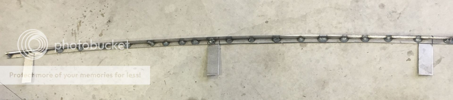

    Then came up with the idea of cutting tabs in the assembly and dropping them into slots I cut out in the spoiler. I wanted the spoiler 1 inch taller than stock so I left a 1 inch strip under the round stock. I used a spoiler I had with a big hole in the center just incase it didn't work out.
  2. Mavaholic
    214
    Next I folded the end tabs over and pop riveted them to the spoiler. For the center, I welded a plate in to cover the hole and help lock the extension in place. At this point the extension is very rigid.

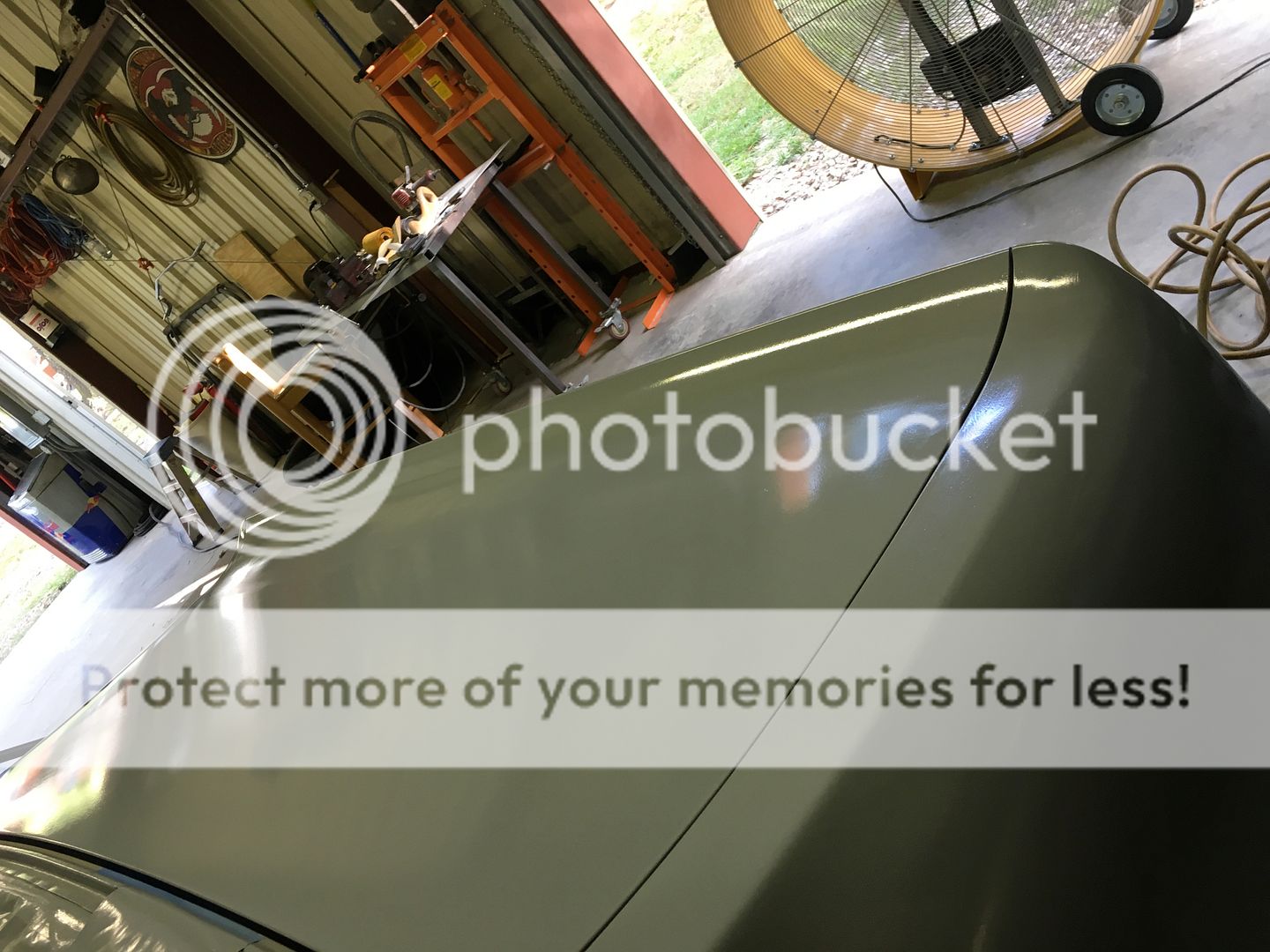

    This is the finished trunk lid and mounted with a stock spoiler end cap.

    Once that all set up I cleaned and glued the end caps to the quarter panels. Then it was just a matter of shaping everything. I used fiberglass reinforced filled to cover the seam between the quarter panel and extension as well as the bulk of the filler to blend and shape everything. Regular filler was used as a top coat.
  8. Mavaholic
    214
    Finished and primed.
