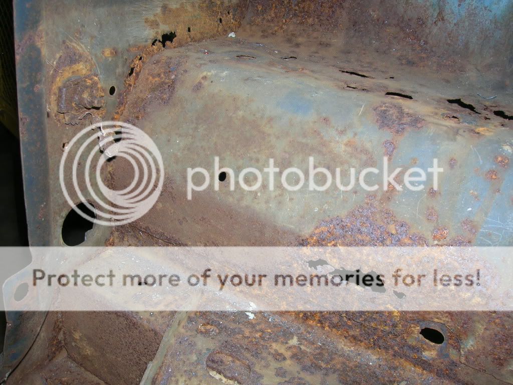

    Tops of all my aprons were rotted out where the metal overlapped.
    Had to make patch panels for both sides. Making that small step was a bitch.

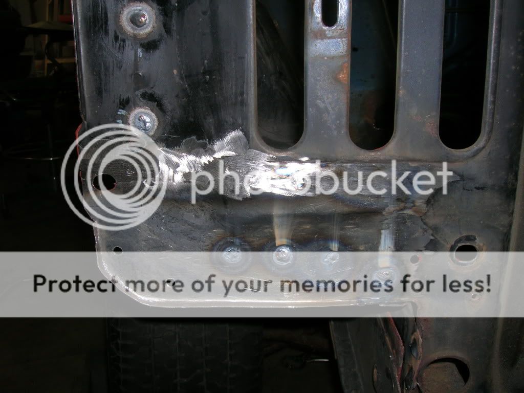

    Patch complete and welded in.

    The battery apron was a goner. It also rusted out the corner of the core support where it attached.

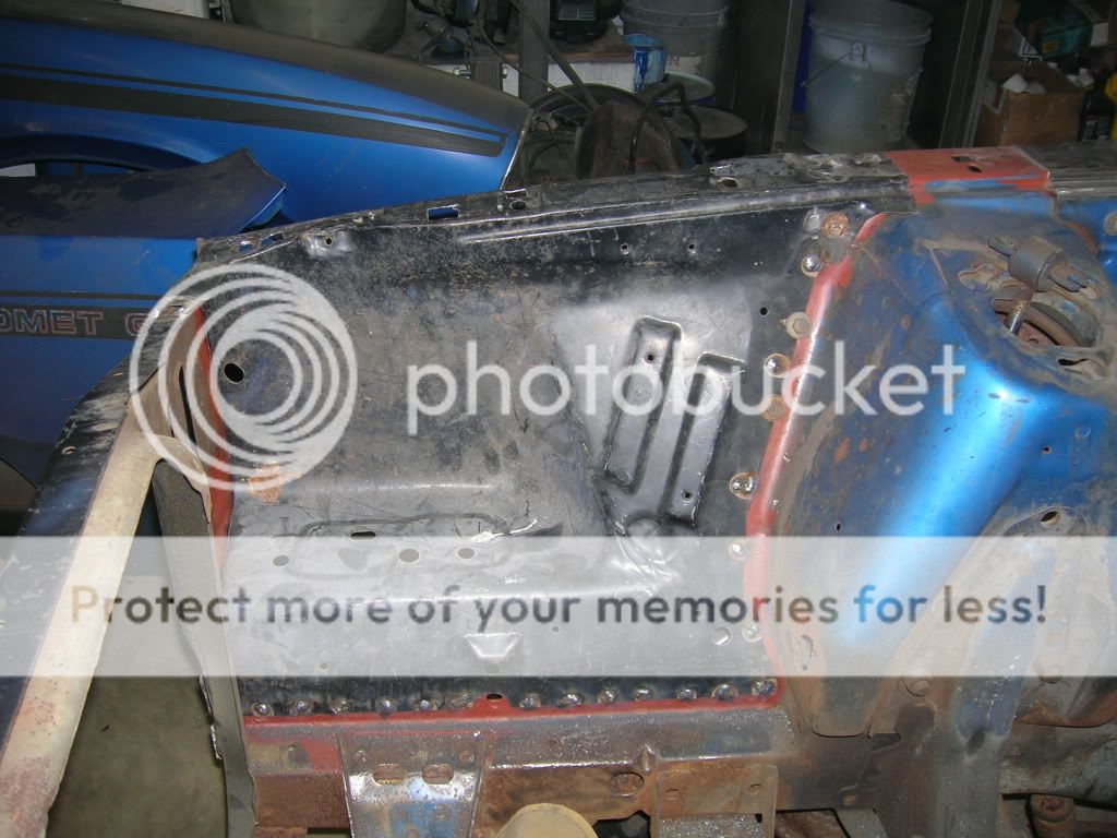

    All aprons and cowl repairs are done and everything is welded back together. I used liberal amounts of Eastwood's rust encapsulator on everything. This repair should out last me.
