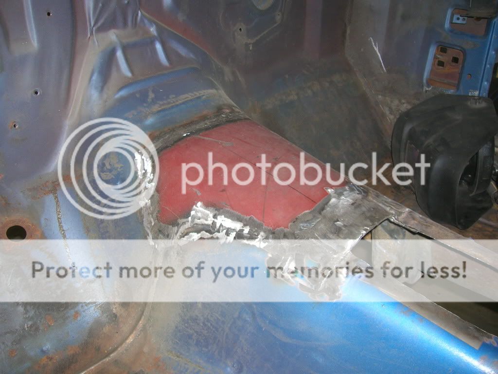

    Time for an update. Last weekend I finished up the trans tunnel. The Cobra R T5 I have hit the top of the tunnel and the upper cross brace so I had to cut it out. I took 1/4" steel and formed a hoop and welded it inside the cross brace. Then cut the flat section out of the top of the tunnel and reformed it with some sheet metal.

    This week been working on the rusted out floor section. Cut out the passenger side.
    Hardest part was cutting out the good floor out of the parts car. It was welded to the rear torque box and spring mount.
    New section welded in.
