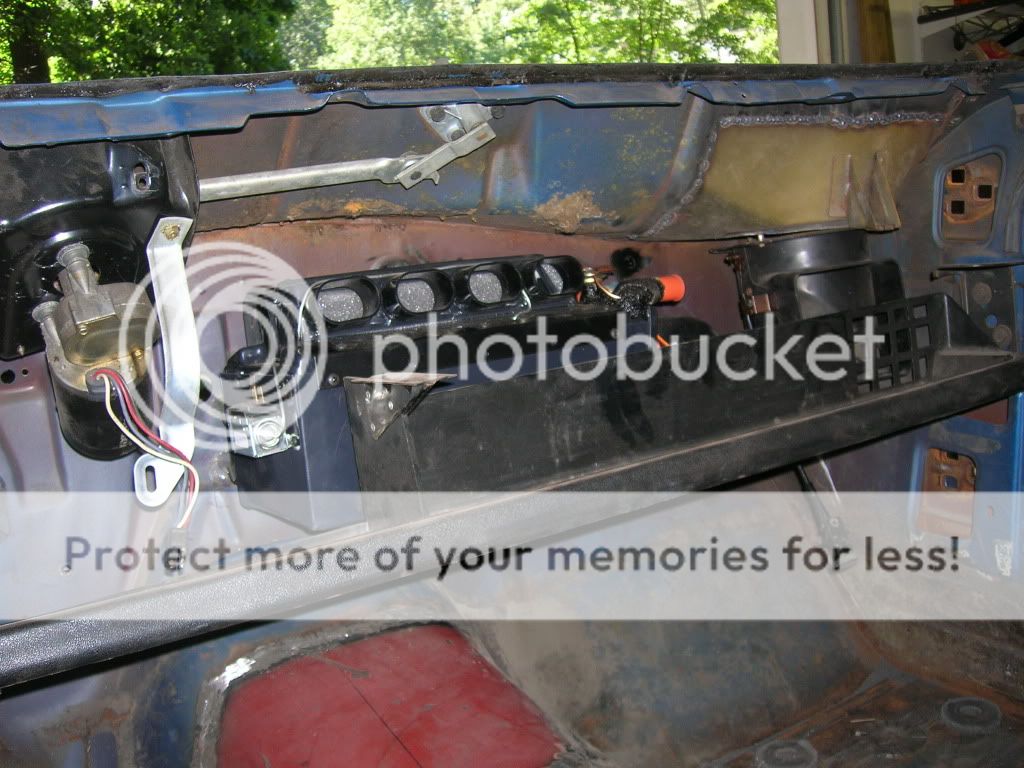

  1. Mavaholic
    214
    Once it is mounted up, there is plenty of room under there. I still need to make a front support but that will be easy.

  2. Mavaholic
    214
    You can see in this picture it fits perfectly behind a non-ac package tray. It still has about 1 1/2" between the tray and the box.
  3. Mavaholic
    214
    I'm using a factory air dash so I can have the center register. You can also see this unit does not hang down near as far as the factory unit.

  10. Mavaholic
    214
    I have a ac package tray with the registers on each end. I will use those but mount them on a standard package tray. It will look like a factory air car when I'm done. Yes, that box has heat and air.
