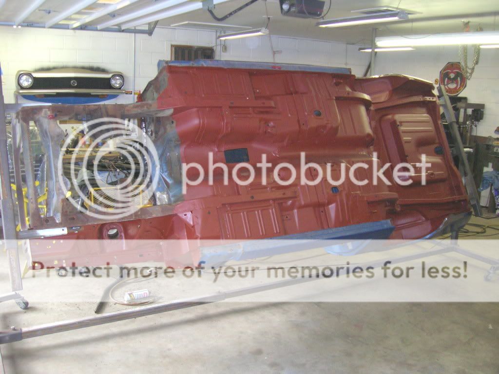

    Been making steady progress on the Comet. All the rust repairs are done. The bottom is cleaned and coated with Eastwood's rust encapsulator. I've decided to coat the bottom with Herculiner. Next weekend is Fall Carlisle so I will pick up some there.

    This weekend I spend sanding. Got the drivers side sanded down to bare metal. It took 4 hrs just to dig all the old seem sealant and sand the rust out of the rain gutter. Once that stuff starts cracking, water gets under it and will rust out the gutters.

    Nice work Dennis. That rotisserie helps out quite a bit, huh?

    Gotta love those rotisseries:bananaman
