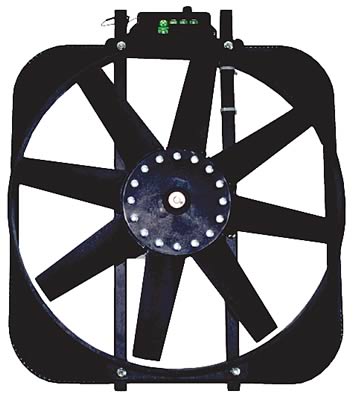

  10. valleyracer
    valleyracer Member
    Mar 19, 2002
    492
    62
    Ottawa Canada
    1977 Maverick Drag car 399 engine,C4 trans,9"with 4.33 gear ET 10.25 @ 128 mph
    Proform 67017
    Just installed this on my car and watched the temp go from 190 to 150 with the car running! Awesome fan!:thumbs2:

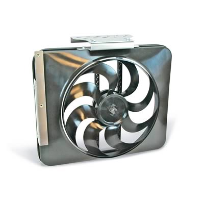

  12. MavMark
    MavMark Mega Modifier
    779
    Detroit Area, Michigan
    That's a Flex-A-Lite Black Magic fan...maybe a model 155?
    I had one of those awhile back...but now I have the Flex-A-Lite 185 "Xtreme" series fan. :) It works very well, but is not cheap:
    You just gotta make sure you have an alternator that is up to snuff. I've got a 200 amp 3G alternator so I'm good....:D
  13. valleyracer
    valleyracer Member
    Mar 19, 2002
    492
    62
    Ottawa Canada
    Proform 67017 $139.95 at Summit
