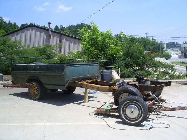

    Well, I left straight from work yesterday afternoon and went straight to NC. I was tired when I left work, and after a 90 mile drive it was all I could do to keep my eyes open by time I got up there. I had intended on coming back last night so I could get over to Jaguar and get an early start on this thing, but I got as far as hooking up the dolly to the truck, then went inside to see my grandparents for a while. Last thing I remember is sitting down on the couch, then my grandpa waking me up about 10:30 PM and telling me to go to bed. So I got up at 8 this morning and hit the the road. Got down to Jaguar Performance about 11:30 A.M. and did some fancy backing up with a loaded car dolly and dropped the dolly there, then went in to shoot the $#!t with the crew for a while and go eat lunch with them at 12. After lunch I ran over to Northern Tools down on Peachtree Industrial Blvd. and picked up a trailer hitch. Got back over to Lawrenceville at 1:45 and got to work...
    If you had seen how far I backed this thing up, you would be impressed. It's very difficult to reverse a loaded car dolly. Everyone was saying I couldn't to do it, so I had to prove them wrong (I didn't really know if I could either). :D I pulled into the parking lot of the building across the street and got it all nice and lined up, had a couple of guys stop traffic, and backed it up across the street up into the parking lot at Jaguar.
    Then I cut it in half with my trusty sawzall and got all excited and forgot to take anymore pics until after I finished it and drug it home. :rolleyes:

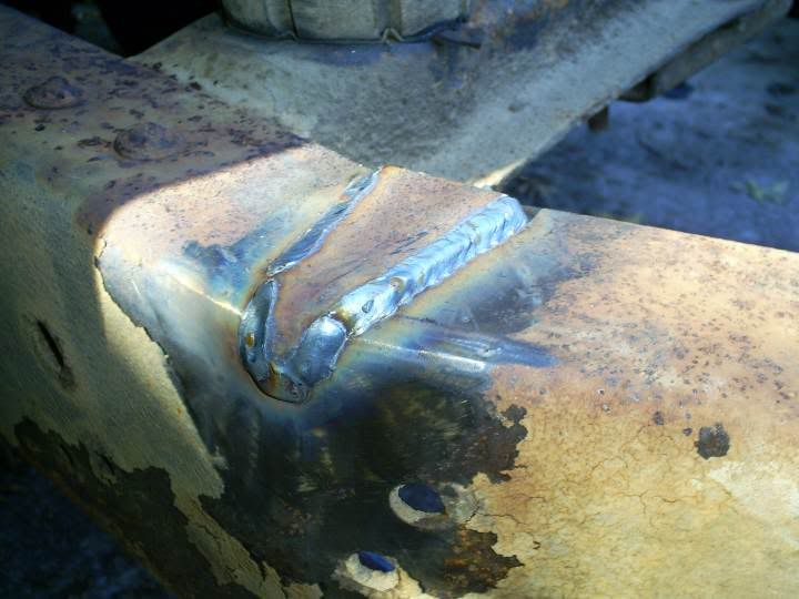

    I V'd out the frame on top and bottom so I could push them together, then took the pieces I cut out, set them on top and welded them back on for added strength. Did the same on the bottom side as well.

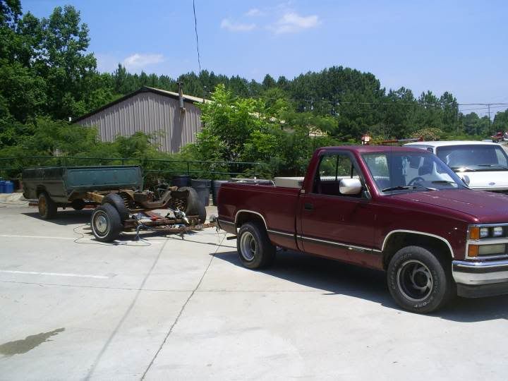

    Anyway, it pulls great, you can hardly tell it's back there. Just need to run to Wal-Mart and grab a trailer plug so I can plug it into the existing plug on the truck, then wire up the tail lights. Then fill out the paper work for a home built trailer and go get a VIN and license plate for it. I was going to take the front half of the frame down to Blaze and get whatever they would give for scrap, but the guy that runs the shop next door came over to see what I was doing and said he wanted it. So I swung down to his shop after I cut the frame in half, and he unloaded the front half off the dolly for me with his fork lift and traded me a nice electric hydraulic pump for it. Got some plans for that already.

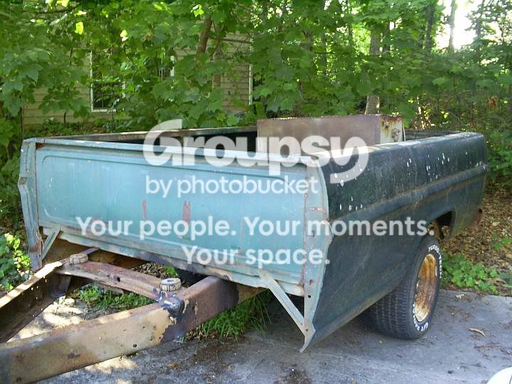

    I also priced a trailer of similar size to this one while I was at Northern, $729. If you even want to factor in what I originally gave for this truck back in 2003 ($75, and I got a good engine and trans out of it for my other truck), I currently have like $105 in this, and this one can haul more weight and has shocks. Not to mention other truck trailers like this are going for $200-500 on Craigslist around here, so it's a win-win all around.
