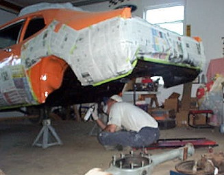

    what is the bottom painted with?
  12. Craig Selvey
    18,345
    1,397
    Eastwood Chassis Black.
