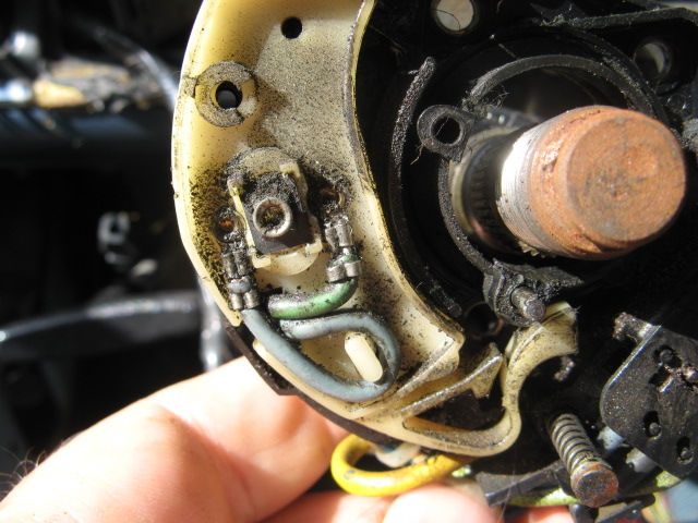

    Thanks Craig. I located one small wiring issue so while I still don't have turn signals I do have all lights working now in parking light mode.
    Thanks Tom for the diagram and suggestion. One question. Are you saying to partially unplug the flasher far enough to expose part of the terminal and then check to see if there is voltage between that tab and any suitable ground?

    Thanks Craig. I located one small wiring issue so while I still don't have turn signals I do have all IMG_1691.JPG lights working now in parking light mode.
    Thanks Tom for the diagram and suggestion. One question. Are you saying to partially unplug the flasher far enough to expose part of the terminal and then check to see if there is voltage between that tab and any suitable ground? No visible blue wire so it must be located on the back side/

    I see yours has a white wire, guessing that's a replacement switch(all my orig '71/ '72 sw have green)... You can check to see if there is voltage on it as with ign on it's fed by flasher... That's for both R & L so if either works isn't your problem... You're probably going to have to check on signal sw connector under dash...

    Still no turn signals. The green, light blue and white/red hash wires all have power at the connector. I removed the switch assembly and removed the cam. There was a small brittle crack on the white wire but not in a place where in was shorting. I repaired the wire with small strips of electrical tape, cleaned all the contacts and put everything back together. Next I removed the cable jacket between the switch and connector. All the wires appeared to be perfect. Never have I been so frustrated working on what looks like a simple circuit. All of the lights work as does the emergency flasher. I hate the thought of spending $100+ on a new assembly. Any last thoughts from anyone?
