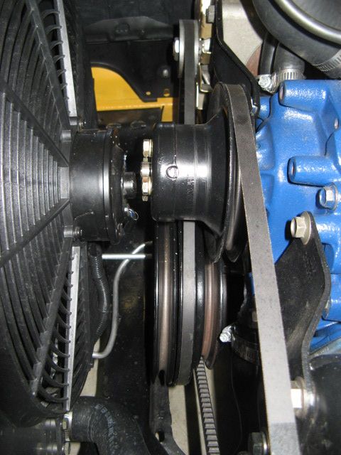

    Oh yeah I know the topic of this thread is depth(sorry for drifting), about every performance shop offers crank pulley spacers...
    This one is result of mounting my orig Comet water pump, pulleys and harmonic ballancer on front of 5.0 that had serpentine belt setup, those timing covers are approx 1/4" thicker than the original '70s covers...
  10. Krazy Comet
    7,802
    2,486
    Dismal Swamp
    Your lower pulley is for a A/C setup, just figure out the amount needed to move it forward and there should be spacers available(are even on ebay)...
    Here is pict of my pulleys that are A/C(same ones in above pict), notice the alt is on center groove(sheath in Ford speak) and P/S is closest to engine, the W/P pulley is no doubt much deeper than yours...
