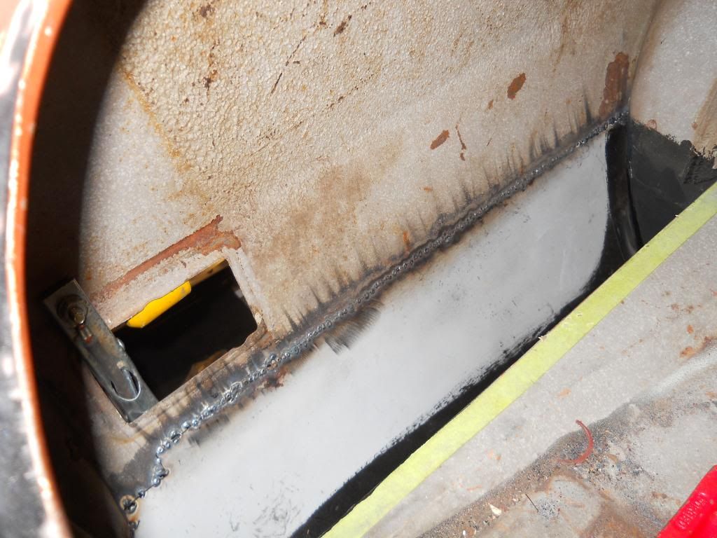

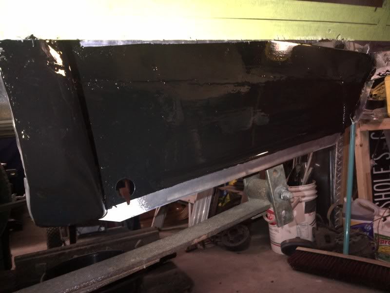

  7. Dave B
    Nothing too exciting, but I got a few coats of POR 15 on the patched trunk drop I made, ground down most of the welds, but it's not really anything you'll see once the car is together...
  8. car-nut
    car-nut Glenn
    Jul 2, 2006
    1,299
    conn.
    progress none the less!
  9. mercgt73
    Nice work, Dave. Like Glenn said, progress is progress.

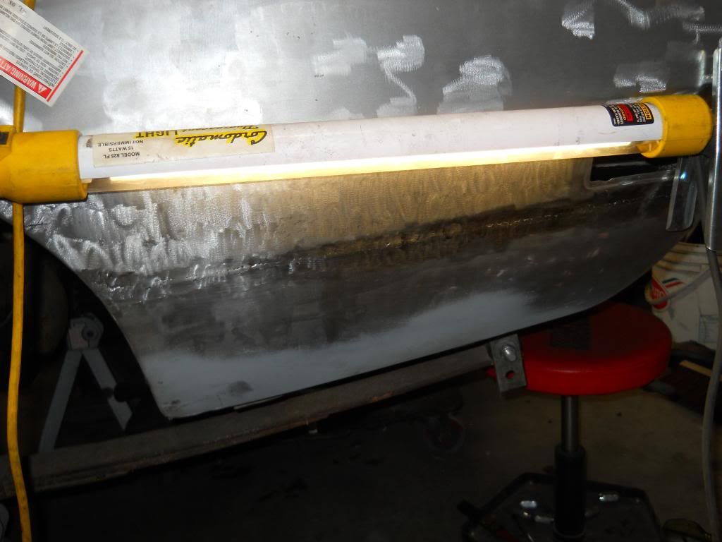

  10. Dave B
    I had nothing but time today..so the welding planets aligned, and I got this done...
    A little gross on the inside, but a quick pass with the grinder should clean it all up.
  11. car-nut
    car-nut Glenn
    Jul 2, 2006
    1,299
    conn.
    Looks great!!!!

  13. 67firebird
    67firebird Member
    May 22, 2012
    64
    newark,de
    71 maverick project
    seam seal the inside after por15 and it will be fine. looking good.
  14. mav1970
    Did you take breaks with the little tacks so nothing warped from the heat? The quarter does look good from your photo.
    I talked to Jean Doll today about welding my bottom patch pieces directly on the body line as M.A.V. had his done and Dale says for me to "go for it" so :thumbs2:
  15. Dave B
    Thanks everyone!
    Nope, one long super hot bead! :rofl2: Really, I had to pace myself, I get a little overly excited when I'm doing this stuff, but with my job I have all the patience...I can sit and watch a ice machine make ice for hours... Lots of little welds, nice and close, I only blew two holes. There is some small spots where it twisted a bit, but they'll come out with the hammer and dolly. It's time for a Bud Light. (y)
