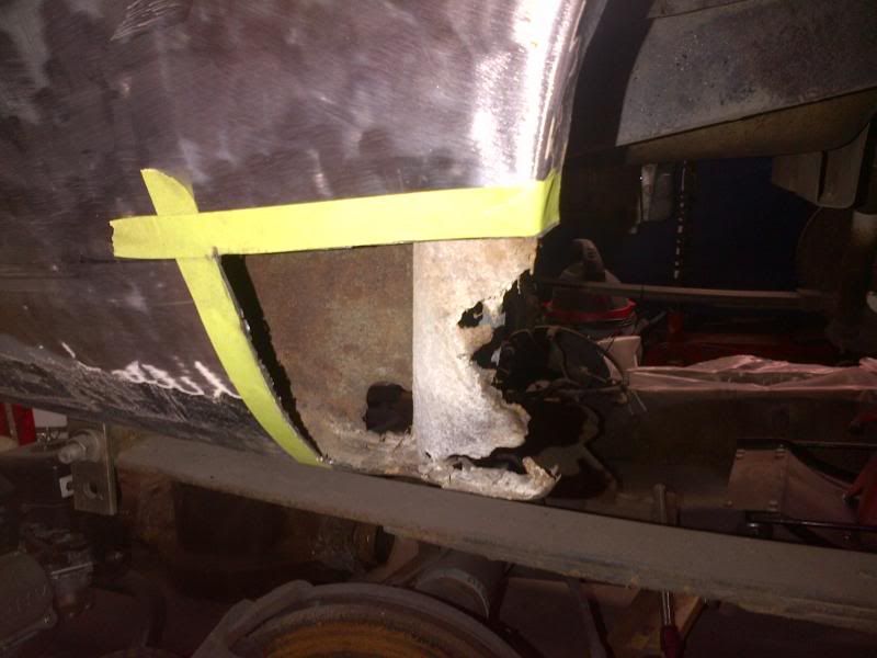

    Rust is the main reason I changed to the Comet, it never had any other then a little surface where the factory never got any paint on it..... I know the Mav was repaired as well as it could be, but it still had repairs and I prefer my car not to have any rust repairs.....
  2. ESampson
    ESampson Member
    Dec 20, 2010
    1,453
    Nanaimo, BC
    1974 Comet GT
    thats not rust dave! be happy about that! you will have that fixed up in no time...
  3. Dave B
    I know....my 74 is from BC...and it was worse 25 years ago...I just told my wife, after this one is done, I will start my 74 Grabber...and it is way worse than this car..but Ive been buying NOS parts for that car..then if I make it that far, I will never buy another rusty car..ever!!

    Your car looks like it has chicken pox. Looking good!!

    I've seen this somewhere befiore, Dave :cry:

    I grew up in Colorado and up until I started to work on the east coast and upper mid west I truly did not really know what a rust car was. It is amazing that a new car in 3 years can be half rotted away.
    I thought the car that I was working on was bad but I truly am luck that it really is pretty much rust free.
    I also have learned that certain peoples explanation of NOS or excellent shape when buying parts is determined on what part of the country you live in.:biglaugh:
    By the way nice job Dave. I can't imagine have more than one car on my plate.

    Looks like tin termites have been feeding on your fenders! :biglaugh:

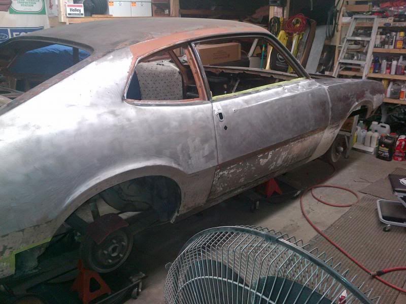

    So, today was another rainy day, so more paint stripping....
    I feel like a traitor....but since I can't buy PPG DP-90 locally anymore...I found this at a new local supplier...I've been reading everything I can about it on every website I could find, and all the reviews have been good, so we'll see...

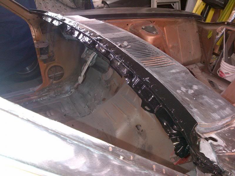

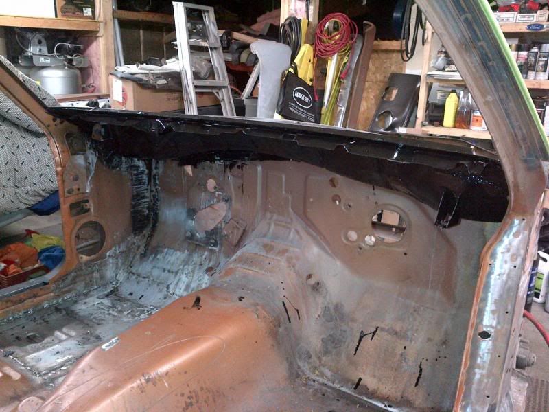

    Waiting on some parts to come in, so I decided to clean up all the welds along the top of the cowl, in the windshield channel. Brushed in two coats of epoxy. Tomorrow I''l finish off the bottom side, with some POR 15.
  12. Dave B
    After 3 years ( I think) the cowl is done, now I just have to finish everything else...

  13. Cruzin Illusion
    Cruzin Illusion Enigma
    Feb 3, 2008
    1,133
    Commerce City, Colorado
    1972 Grabber
    Looks good! Hopefully future progress is at a faster pace.
  14. Dave B
    Would be nice, but I'm in no real rush....Gives me something to do on weekends...:rolleyes:
  15. mercgt73
    Nice job, Dave! I will be glad when my cowl looks like yours does now. :thumbs2:
