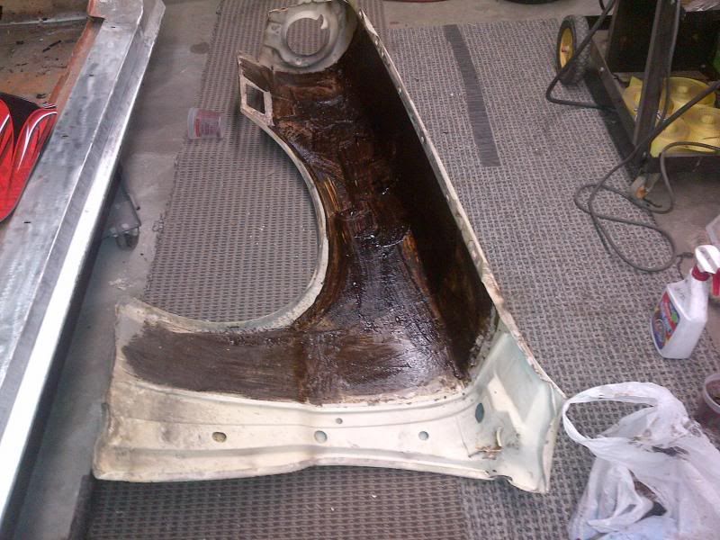

    So today's project is to get all this crap off the inside of the fender, so I can just cover it again.....

    Too much work lol.. Just apply over it. I'll never know it's like that. :rolleyes:
  4. Dave B
    But....I will.....:cry:

    So what are you using to get that junk off? I've read where guys have used everything from "peel away", to degreaser, torching, to just old fashioned elbow grease and a grinder wheel.
    Nice progress! :bouncy:
  7. Dave B
    Paint Stripper, two coats and it came right off. (y)

    Looking good, hope to see you making a lot more progress over the winter. & i also used the paint stripper for that, worked great.

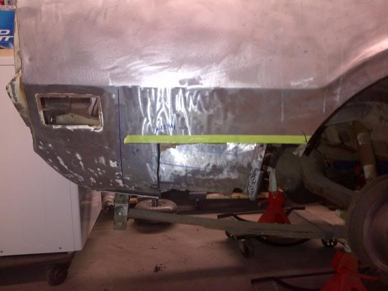

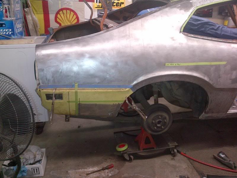

    Nothing too exciting, just cutting and fitting, Thanks again to " Maverocket " for the piece of the quarter panel I needed.

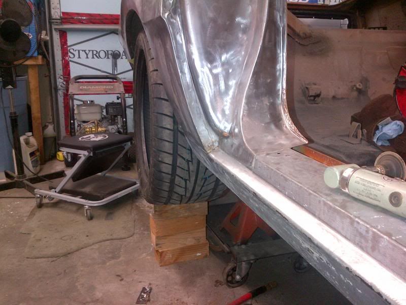

    Also scored a deal on some rear tires at coffee this morning, a pair of Nitto 555'S 275/40/17...It just seals the deal on mini tubing to get these 11+ inch wide tires to fit nicely.

    Come on, it's fun!! I can't decide if I should cut this down, or just use it full sized....
  14. mav1970
    Mine got a tad complicated :cry:
  15. Mavman72
    Best to just use the whole panel Dave...The welding will be a simple straight line. The rest is gravy...
