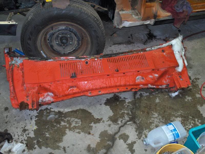

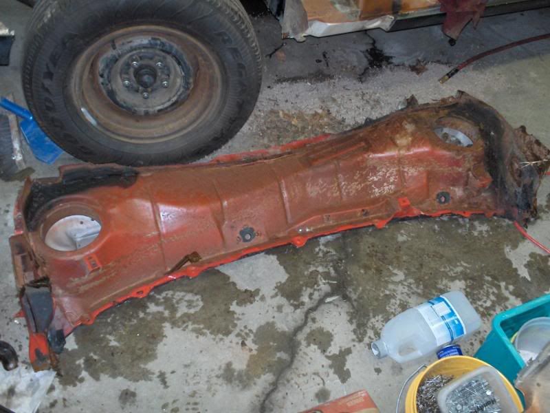

    I just happen to have this, it was out behind my garage. I cut it out of a 75 Non-A/C Comet, so now I can have A/C and a fresh air vent.

    A little more cutting, and some grinding, and I should be able to tack this in, this weekend.
    I bought a air saw..this makes it a little too much fun!
    I'm going to sand blast the whole piece before, I weld it in..it's just surface rust, from sitting in my back yard for 8 years :)
