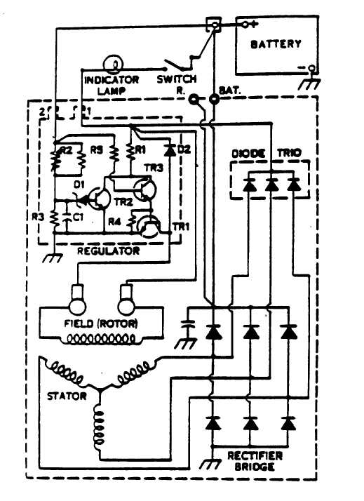

    Is this the wiring diagram for your Alt??

    Affirmative KC, that looks correct.

    OK since the charge light is always on of course means it isn't charging, but real reason is because the bulb is provided a ground path through the diode trio and on to lower section of rectifier bridge... Assuming the regulator is OK(I'd say likely if rotor is energized) and stator isn't shorted/open, about the only possibility is the upper portion of bridge is open, not allowing a voltage output which places a positive voltage on ground end of charge lamp... It isn't going to light when there is positive on both ends of bulb... Sooo looking at your previous posts I'm gonna say the upper three diodes in rectifier bridge are open or have a connection problem...
    With stator disconnected, check each diode section of rectifier to be sure it shows resistance in one direction and open with meter leads reversed... Use either Rx1/2 or diode test if they are separate functions...
    You can also try full fielding which would be to ground the connection from rotor at TR1... If that starts charge it's a regulator issue... Unlike the Ford alts, doesn't appear that point is accessible from outside case??

    Today I did re-check each of the six diodes on the bridge and they seem ok (flow in one direction and not the other, tested both banks and had same result). Diode trio passed same test.
    The one item that I haven't really been able to test is the used regulator that I put in. Odd thing is....that regulator was working when I freshened up the unit about 4-5 years ago. I thought the Delco units were potted and not susceptible to "shelf wear/moisture". Hmm, so there may be the possibility I swapped a bad unit for another bad unit.....:cautious:
    I have the unit disassembled in a box now, but there is a hole in the back to full do a full field test. I'm booked until next weekend....so will be a while until I can proceed.
    Thanks for the assistance, much appreciated.
