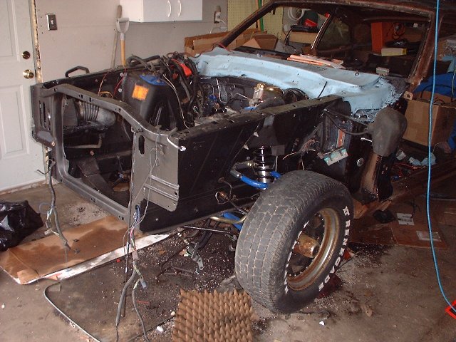

    You can have handling and fuel injection on your Maverick. It just takes a little more work since you will have to install things that were mostly never intended for the Mav. For handling, I installed a TCP coilover kit(http://www.totalcontrolproducts.com/coil.html). Although it was designed for Mustangs and Cougars, all of the parts interchange except for the strut rods. I also installed a 7/8" sway bar in the front and a 3/4" sway bar in the back. Here is a pic of the suspension as I was building my Mav last year: http://www.maverickcomet.com/ProjMav/sm6_9_03/smDSCF0002.jpg
    Definitely not the cheapest option, but everything bolts on, and I think it is a nice alternative to a full blown rack-and-pinion conversion.
