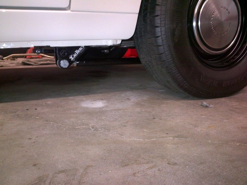

    Dave, would you be able to post a pic of your CalTracs installed?
    I'm wondering if they will clear my side exit exhaust that is in front of the rear tires.
  14. Dave B
    Let me know, if this answers the questions.
  15. 71gold
    2,935
    clean looking...:thumbs2:
