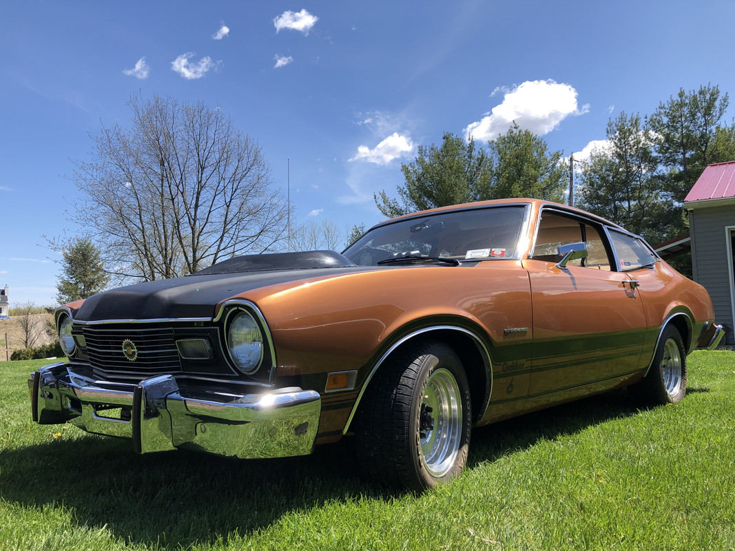

    You forgot to remove the battering rams...

    Agree that "tucking" the big bumper does look better, but since I am fortunate enough to be able to afford going all the way with the small bumper swap, I'm committed to that.
    I'm toying with leaving the '74 lower fender extensions in place, and trying to adapt a '65 Mustang valance to fit, ra
