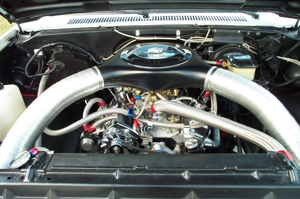

    Nice! What kind of cold air kit is it?

    Ramairbox.com Gene

    I love that cold air intake.

    What intake manifold is that?

    Maybe it's been changed up but IIRC, he was using a Vic jr on his previous smaller bullet. Personally, I'd be porting that little manifold to within an inch of its life and using tall spacer(maybe a combo of tapered AND open) to increase plenum volume for such a good breathing combo like this. Or better yet.. move to a mildly/moderately ported Super Vic to pump up the volume. Especially with the shorter rear gear being installed now.
