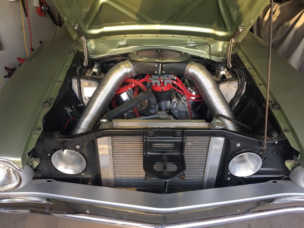

    Update on the changes. The original Ram Air box i tried just wouldnt fit under the hood so i had to sacrfice the Ram Air effect for just Cold air. This contraption attaches to the breather itself. Its a horribly conceved system that could be great but isnt. Lots of finagling and fabbing to get it to work. So this is it essentially. I needed to relocate the VC breather to the back on the drivers side, trim the hood and relocate my radiator over flow catch bottle. Im going to paint the visible portions behind the grill black tonite so it cant easily be seen on a walk around. 4.30 gears are in so Im going to drags this friday night.
