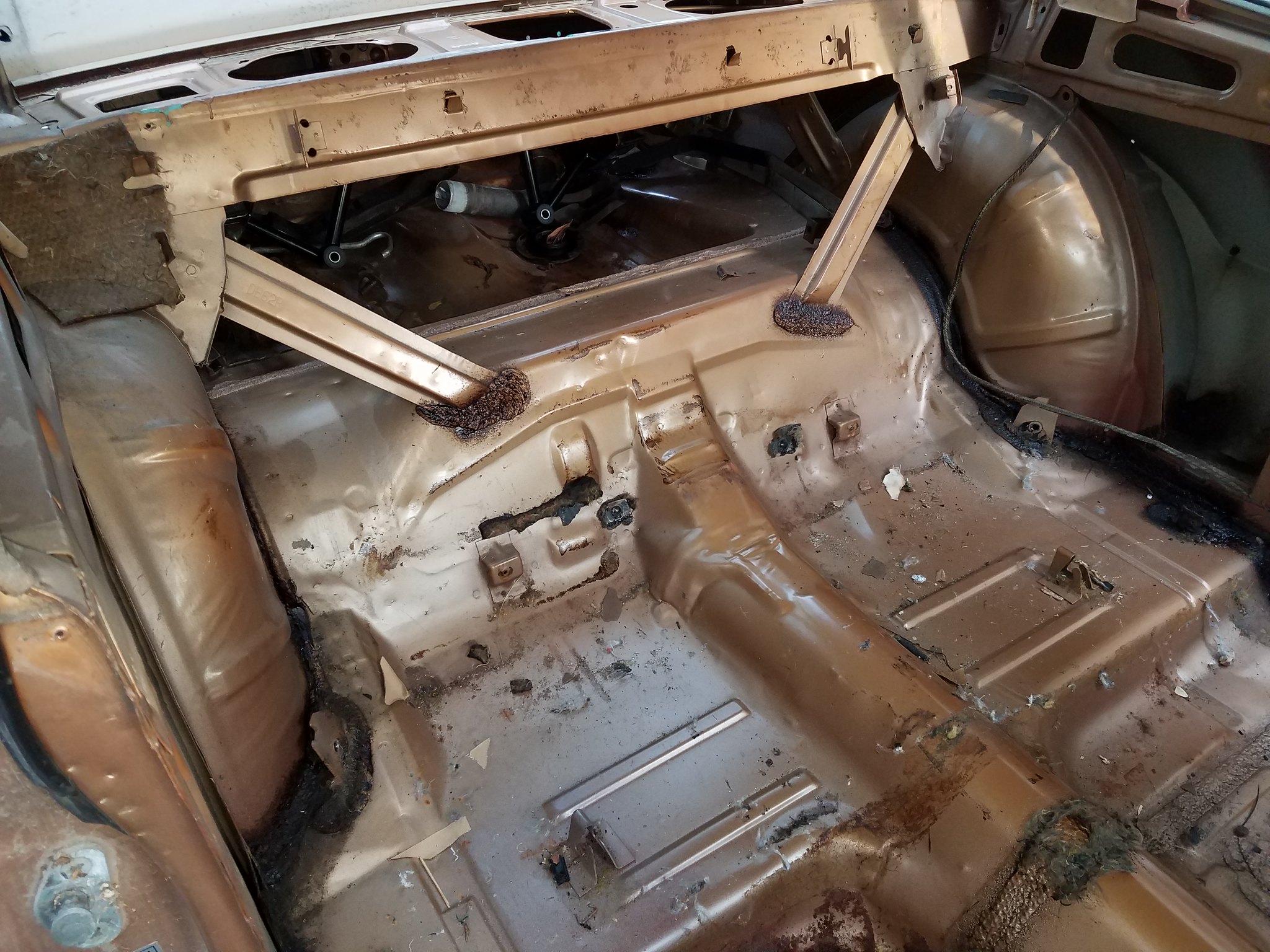

    Really clean in the back seat area, no signs of rust whatsoever. Seat is being deleted and a full roll cage will be installed. Mini-tub will also be completed to fit the new 3-link & new rubber.

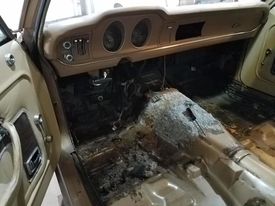

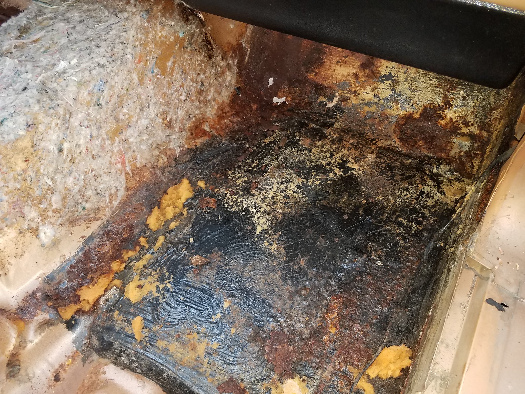

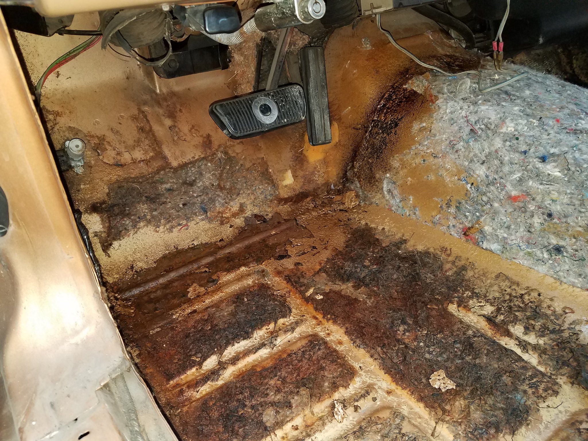

    Front floors are a different story. I knew this but this is not virgin territory. The passenger side floor has been repaired before and not well and I'm going to have to take a close look at the drivers side. So far the drivers side is just surface rust. I've got to track down where the moisture is entering the car.
    [​IMG]20180319_181944 by i.e.427, on Flickr

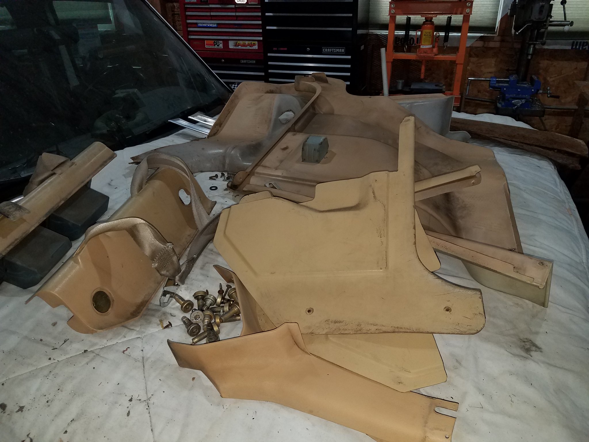

    Some of the interior pieces I'll be hanging on to for the time being.

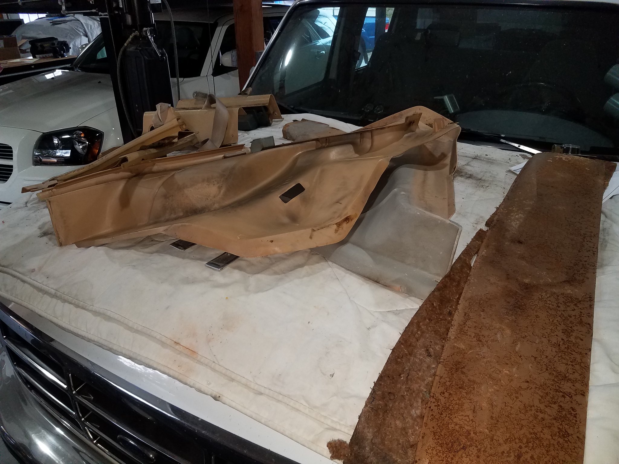

    Most of the cockpit will end up with new aluminum panels. But where flat panels are not feasible, I may recondition the existing plastic interior pieces and dye them to match the new interior.

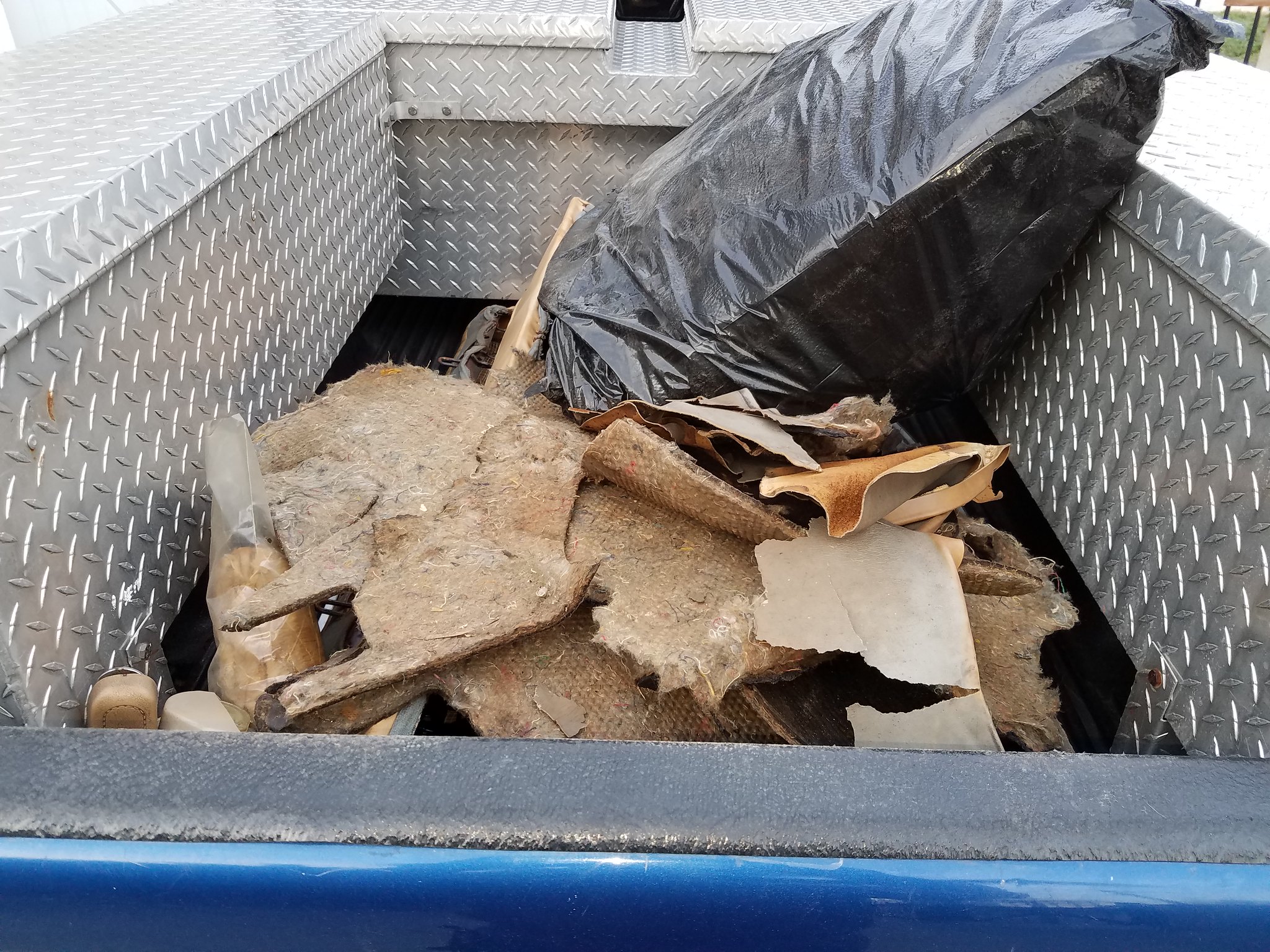

    The next few pictures are of all of the "stuff" going into the dumpster over at the shop tomorrow.

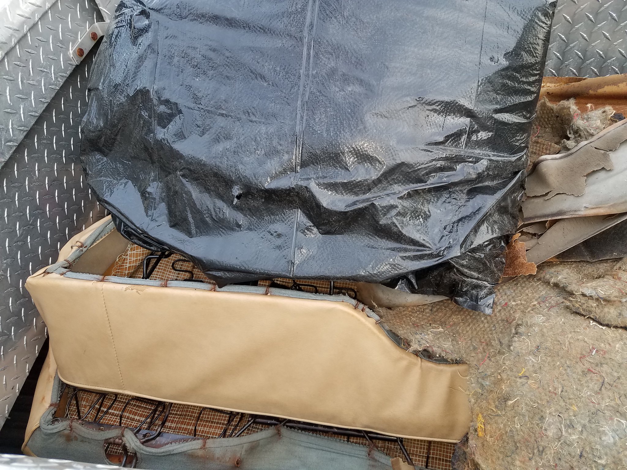

    Finally sold off the engine, trans and rear end locally on craigslist. The rear seat went into the dumpster on Monday and was picked up on Tuesday. Sorry.

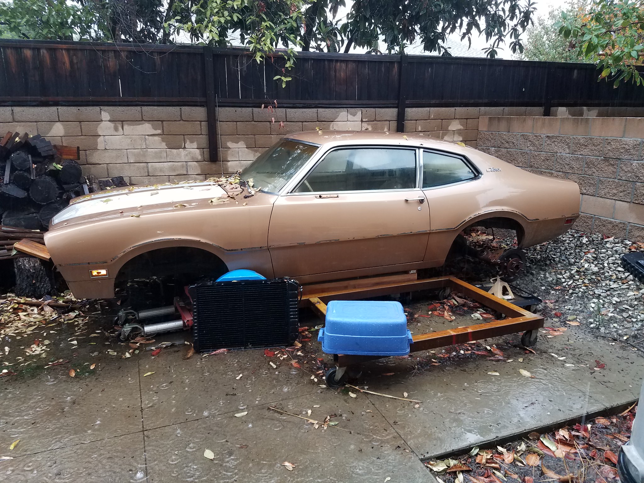

    She's been sitting idle since I last posted here. I've got to get her back on 4 wheels so she can come into the shop when it rains. She is so sad.

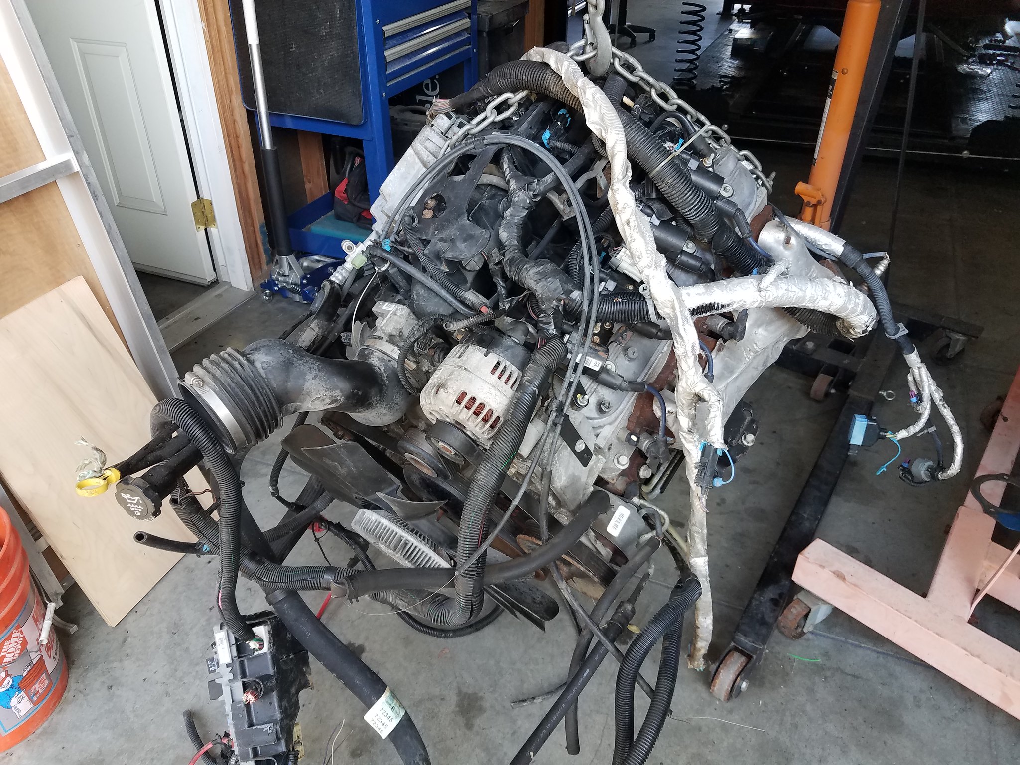

    I did manage to find a low mileage 6.0 engine and I'm in the process of tearing it down (limited) to install some HP parts.
    [​IMG]20190530_173047 by Frank Maslowski, on Flickr

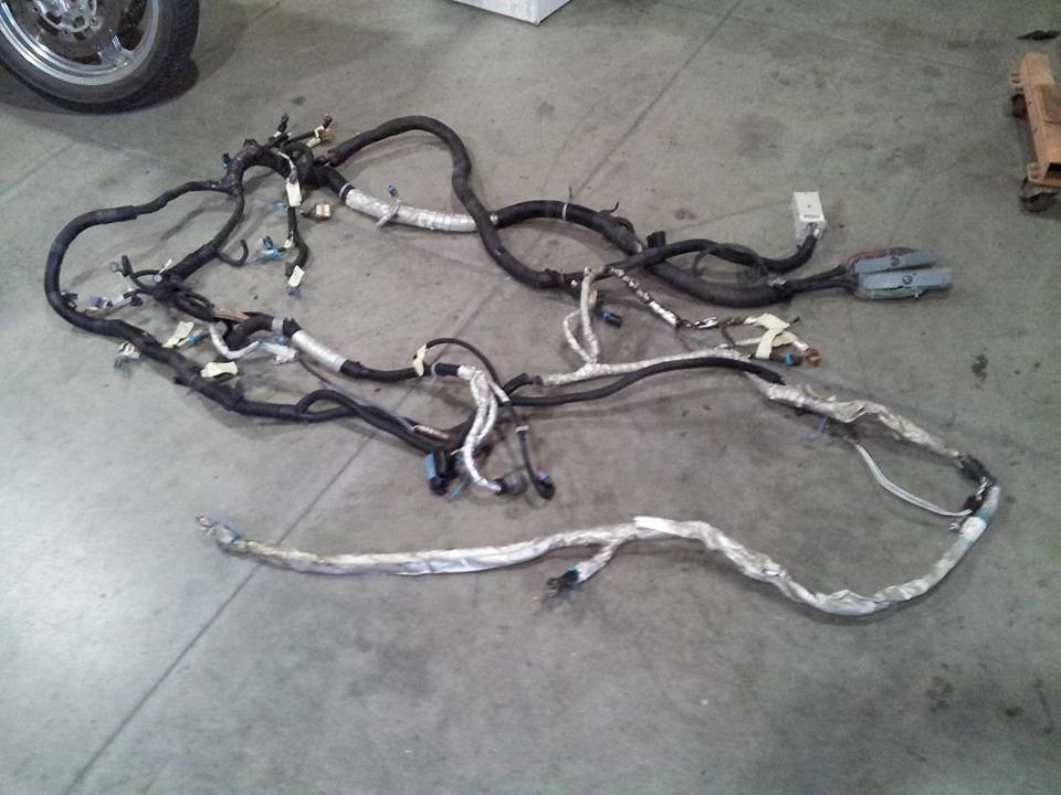

    Engine harness carefully removed. Haven't decided whether I'm reusing it with the stock ECU or going with the Holley Terminator X system.

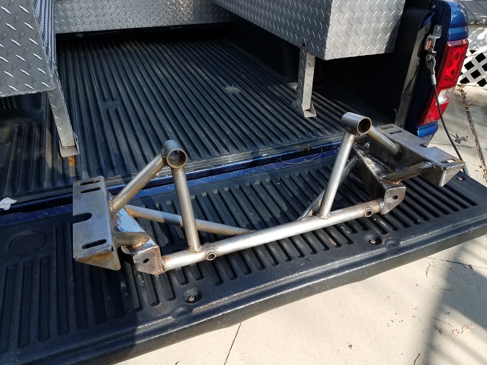

    I ordered a AJE Colt 65 K-Member about the time of my last postings here. After reading quite a few "issues" regarding the welding of these, as reported on the AJE members facebook page, I decided to have the powder coating removed and inspect the welds for myself. All in all the welds looked pretty good, all had decent weld penetration. But I did decide, since it was all stripped down, to add welds to the back side of all the welds in all of the critical areas. It's now at the powder-coaters getting a fresh coat of gloss back.
    [​IMG]20200104_140747 by Frank Maslowski, on Flickr

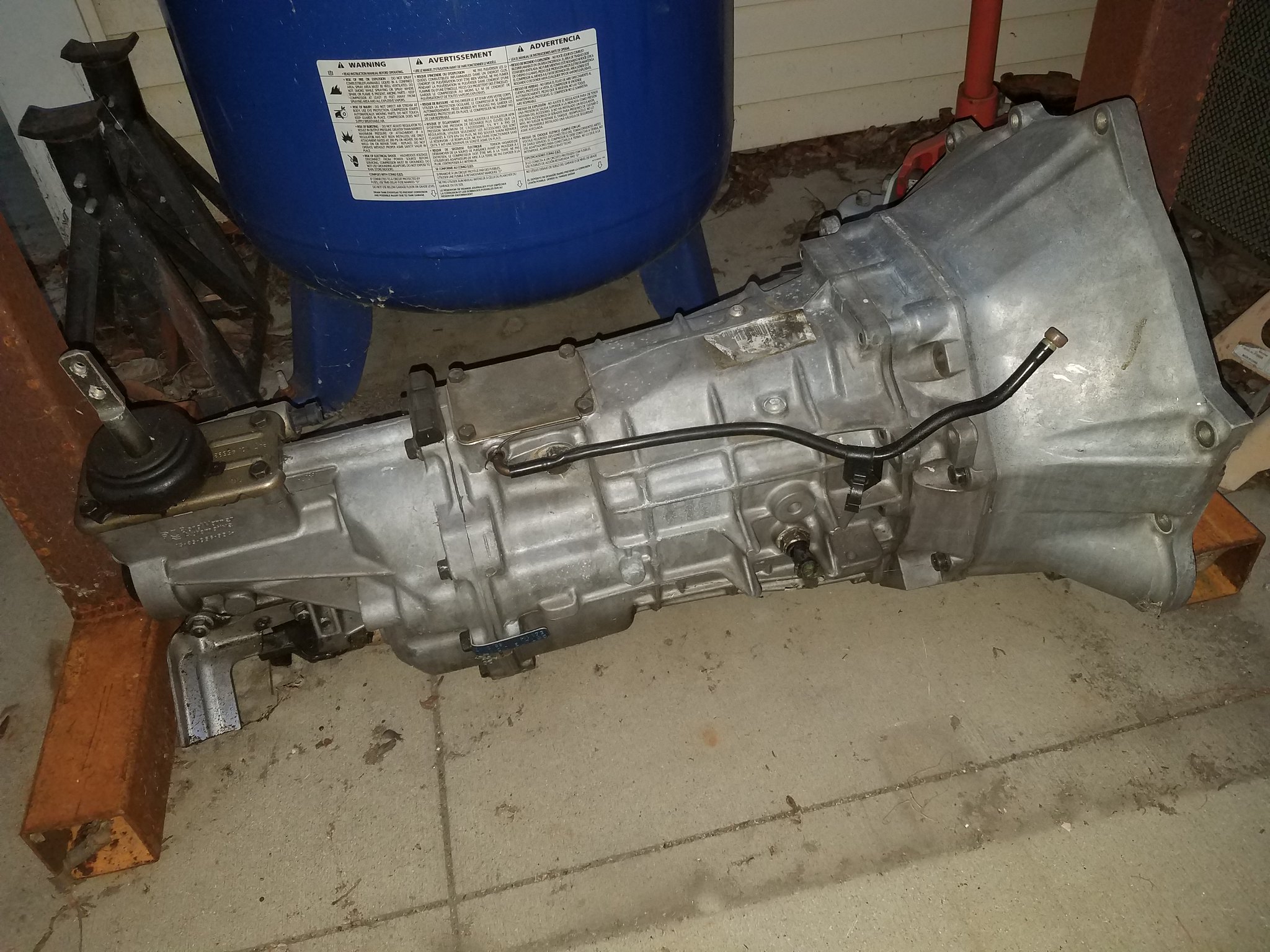

    Lastly for now, change in plans for the manual trans. I picked up a T56 from the same company I got the engine from. Again, a low mileage piece and designed to mate up right to the back of the 6 liter engine. I'll dig up a picture of it later.

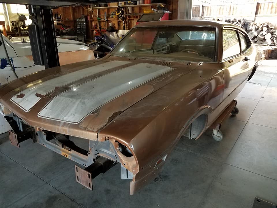

    We're supposed to be due some rain tomorrow so a big effort was made today to get the Maverick inside the shop. Got the car off of the temporary (wood) dolly and on to this recycled steel body dolly. We then pushed her inside. Tomorrow we're hoping to get the steering column out and dash cluster. Maybe pull out some of the 50 year old wiring behind the dash as well. Stay tuned.

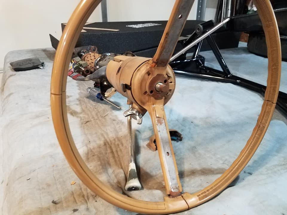

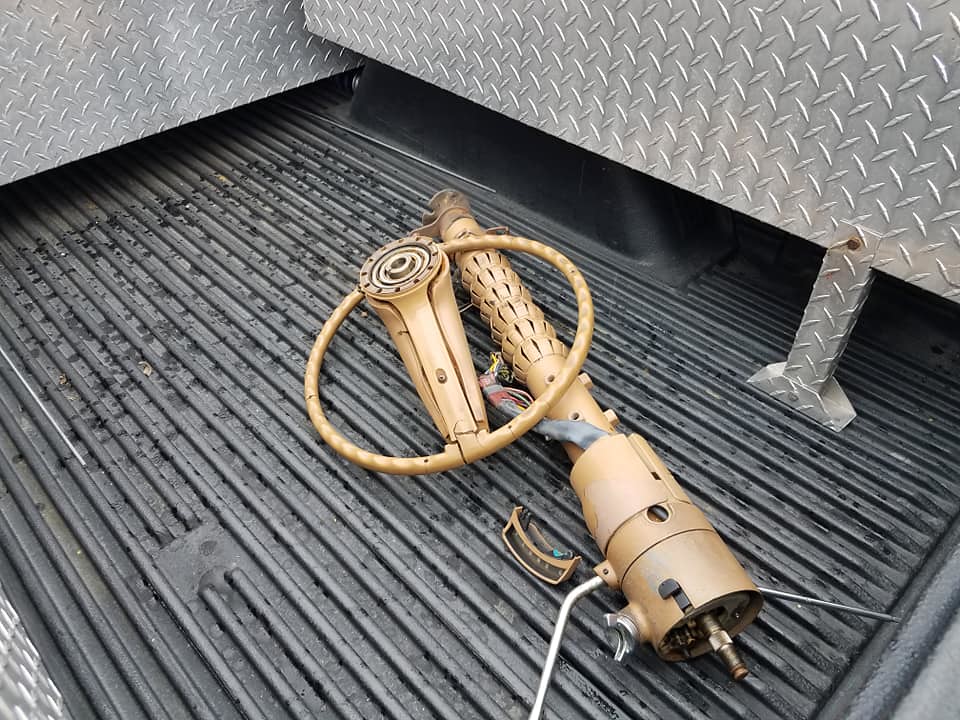

    Had a few hours today to dive inside the Maverick and get some of the stuff out of there. Steering column was first. Going manual trans so column shift isn't needed and this thing is pretty clapped out.
    [​IMG]Steering column by , on Flickr
    It's going to fit in the dumpster a lot better without the steering wheel on there.

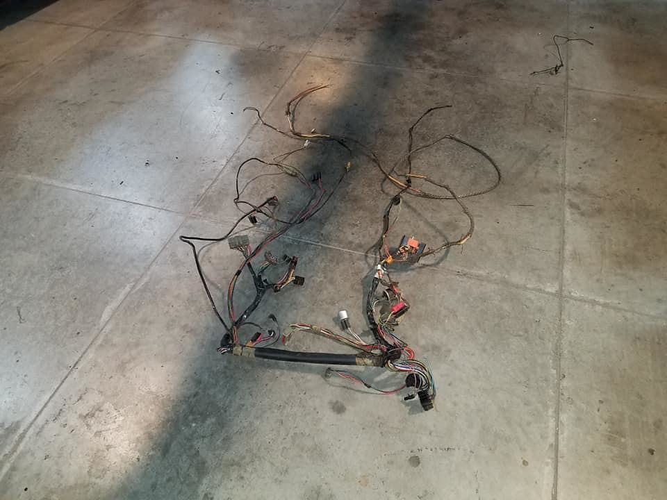

    The wiring harness was pulled out pretty much in one piece. Grabbed the connectors I thought I might need so in the garbage this goes as well.
